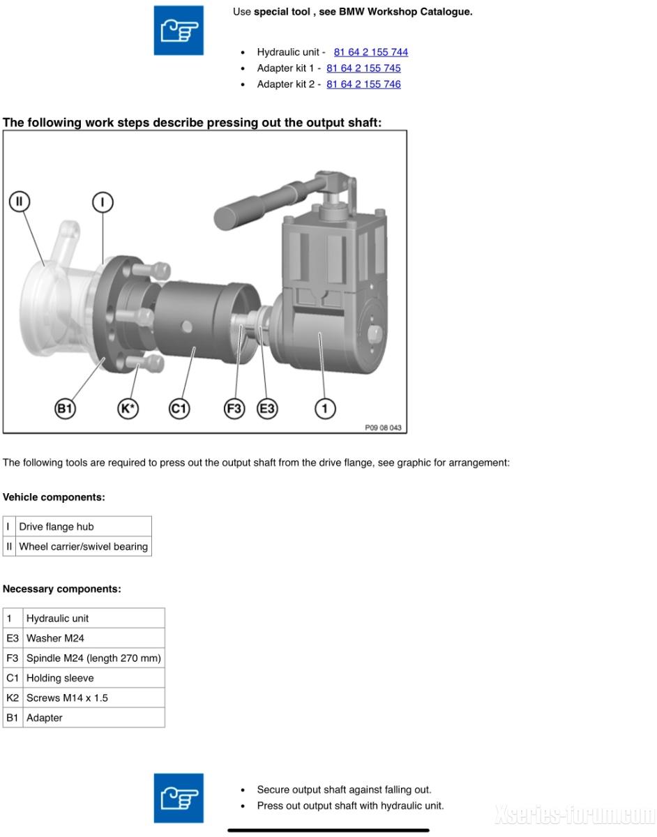

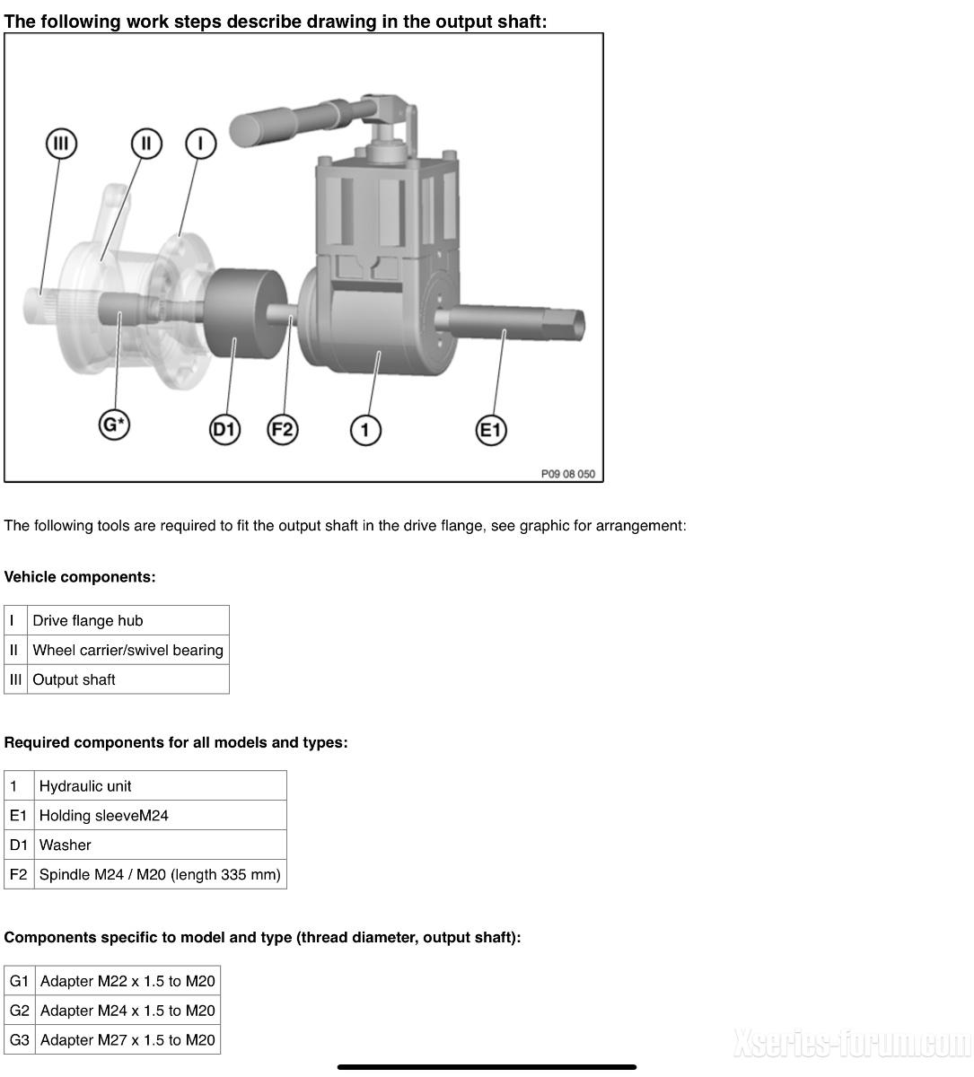

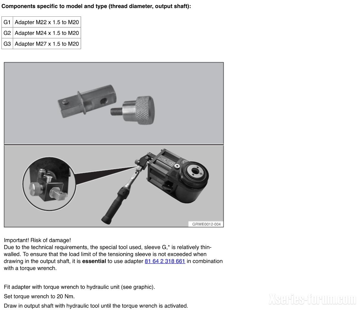

If it helps….
Press out tooling …
Posts: 1952
E53 rear half shaft removal
Post by henrym3 » Wed Jan 15, 2025 6:05 pm
I would have to say there are some fancy looking tools there which would probably cost more than a drive shaft, I’ve had them out years ago using a fairly hefty brass drift. Dropped the shaft at the diff onto a piece of wood just to stop it hanging and then knocked it out of the hub. Did have to fiddle with a jack to move the suspension but don’t remember exactly the sequence. Of course you could just be unlucky and those splines are stuck. If you know the cv is in good nick I still favour you cut the boot off and separate the cv joint or worse case scenario get one of those boots you cut to size and have a groove for glue. If the splines don’t slide out then your not using a big enough hammer LOL.
