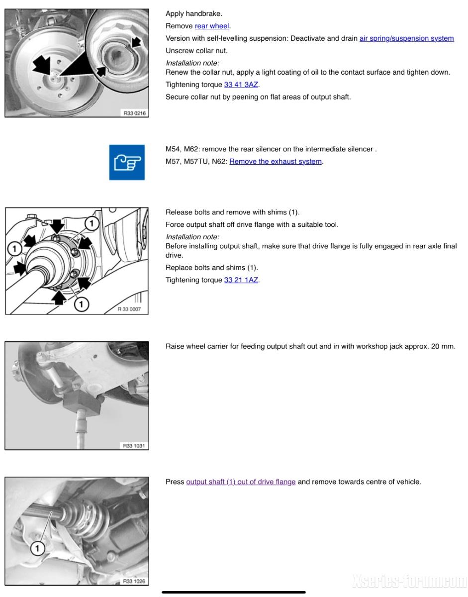

E53 rear half shaft removal
No requirement to do so in the book, but it does say that you need to have the suspension under ‘load’. This is achieved by raising the rear wheel carrier by 20mm.
It does say you need a hydraulic press the shaft out of the drive flange.
I think it’s been done a few times on here so there ought to be a thread somewhere.

Just been looking myself under what I thought were the right keywords, but nothing yet. Press definitely needed to get the old ones out and new in to the drive flanges/bearing carrier.

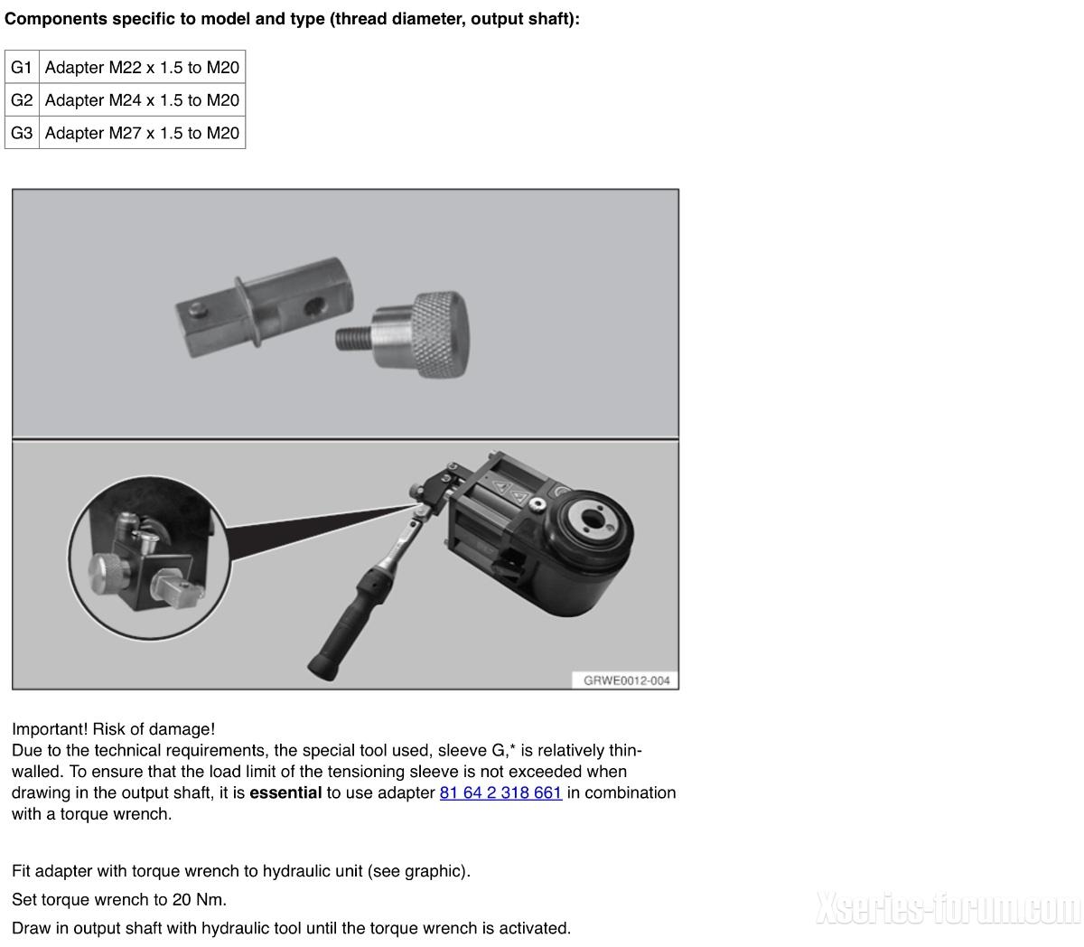

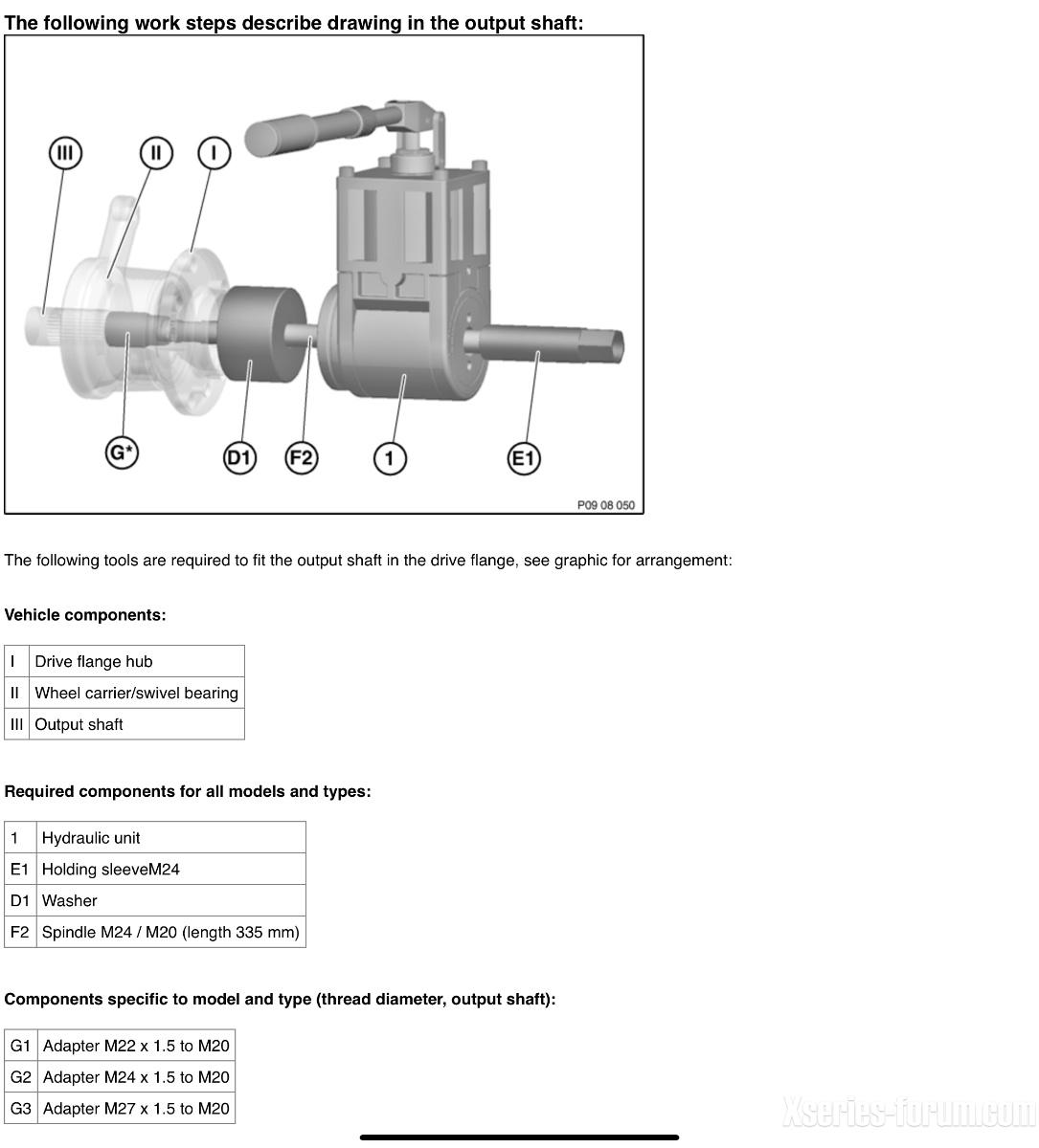

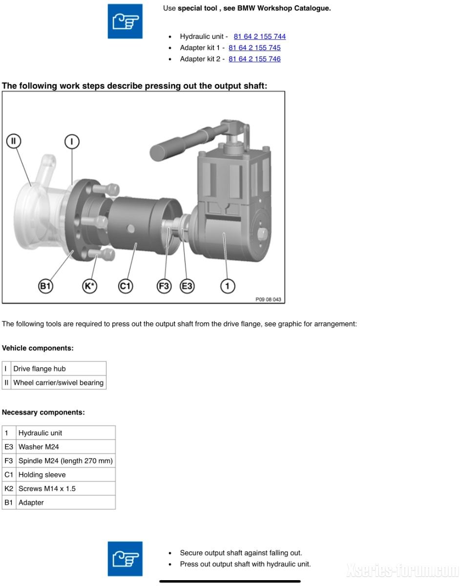

- henrym3
- Posts: 1962
- Location: Bournemouth
I would have to say there are some fancy looking tools there which would probably cost more than a drive shaft, I’ve had them out years ago using a fairly hefty brass drift. Dropped the shaft at the diff onto a piece of wood just to stop it hanging and then knocked it out of the hub. Did have to fiddle with a jack to move the suspension but don’t remember exactly the sequence. Of course you could just be unlucky and those splines are stuck. If you know the cv is in good nick I still favour you cut the boot off and separate the cv joint or worse case scenario get one of those boots you cut to size and have a groove for glue. If the splines don’t slide out then your not using a big enough hammer LOL.

Re shaft removal... and the specific bit of raising hub 20mm - this proved impossible due to me having +50mm lift heavy duty hard springs on the rear, so, I got some 300mm spring clamps that I have cut down to 140mm long, just enough to get the sodding things in the available space to squeeze the springs & make the hub straight in-line with the diff & shaft etc to pull the shaft out intact in one chunk....
this is a Saturday job.
re splines - problem solved with a foot chunk of 30mm nylon rod & a sledge hammer - no problem getting the splines to move at all lol.

BMW will always have ‘special’ tools so as to justify their ‘special’ pricing. No one outside a dealer or specialist Indy is likely to have them so as suggested, brass and a suitable hammer, maybe even a slide hammer might do the job for less faff and cost.
