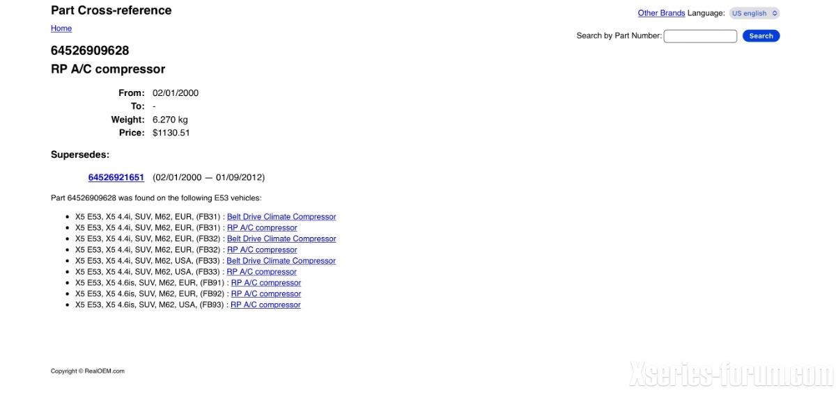

Post by Themoog2 » Mon Jul 18, 2022 9:11 pm
Can one of you experts please confirm that this part number is the correct ac compressor for an 01 E53 4.4.M62tu - 64526909628.
I’m finding new ones for circa £200 if that’s correct. Ta
Posts: 19053
Engine vibration
Post by X5Sport » Tue Jul 19, 2022 5:35 pm
This is the model list for E53….
