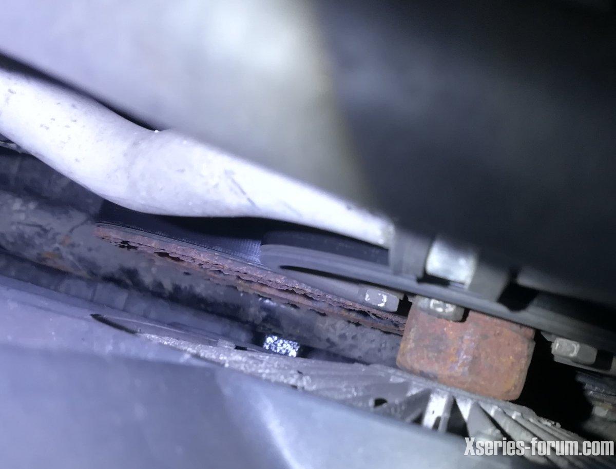

I've had a look at the balance pulley - it's a bit tight from the top but I've taken a photo. It looks pretty rusty to me.. I wonder if it is that.
The car is going back to the transmission shop next week at some point so they will take a look.

I got under it today to take a look. The harmonic pulley looks ok and is firm.
