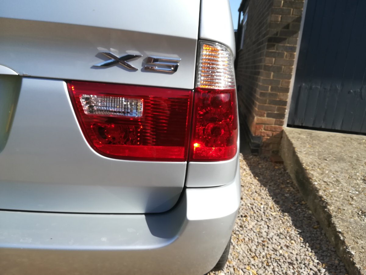

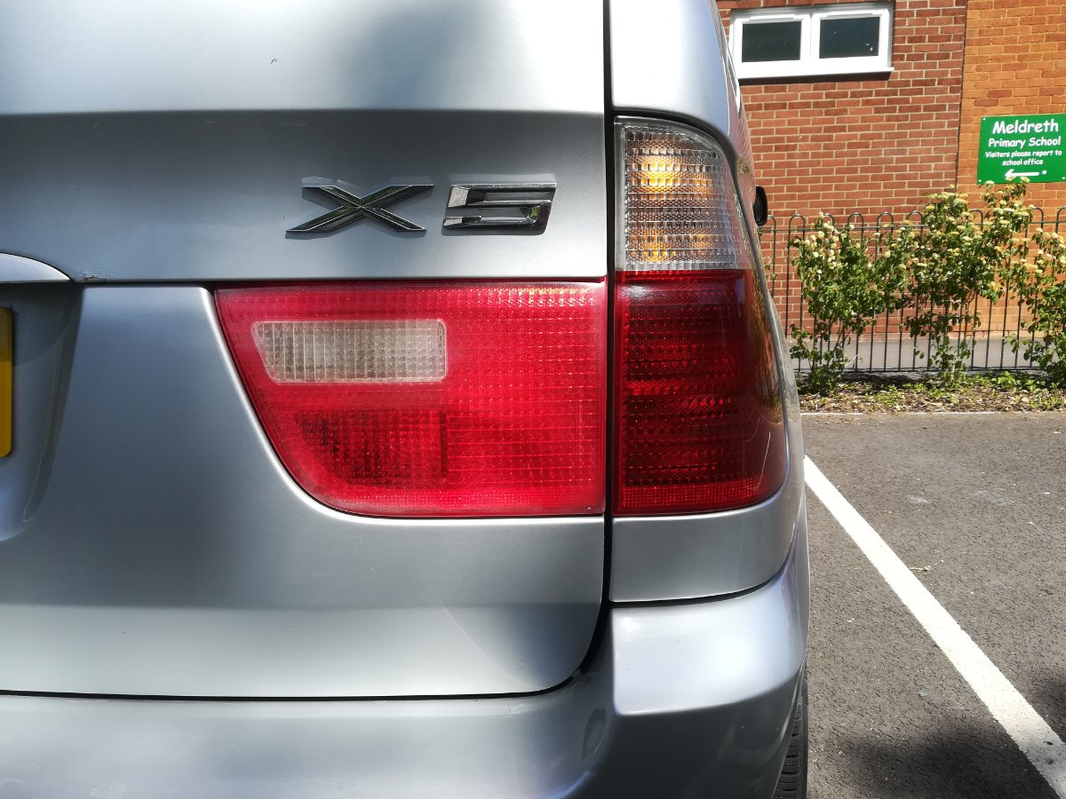

Well look at this.. I saw a rear light set listed on fleece bay at £94. Yes £94 - brand new. Not original bmw but I wasn't bothered so I snapped them up.
Just fitted them and they look really good and all working OK. They came complete with bulbs ect.
Top picture is after fitting.. Wrl chuffed.

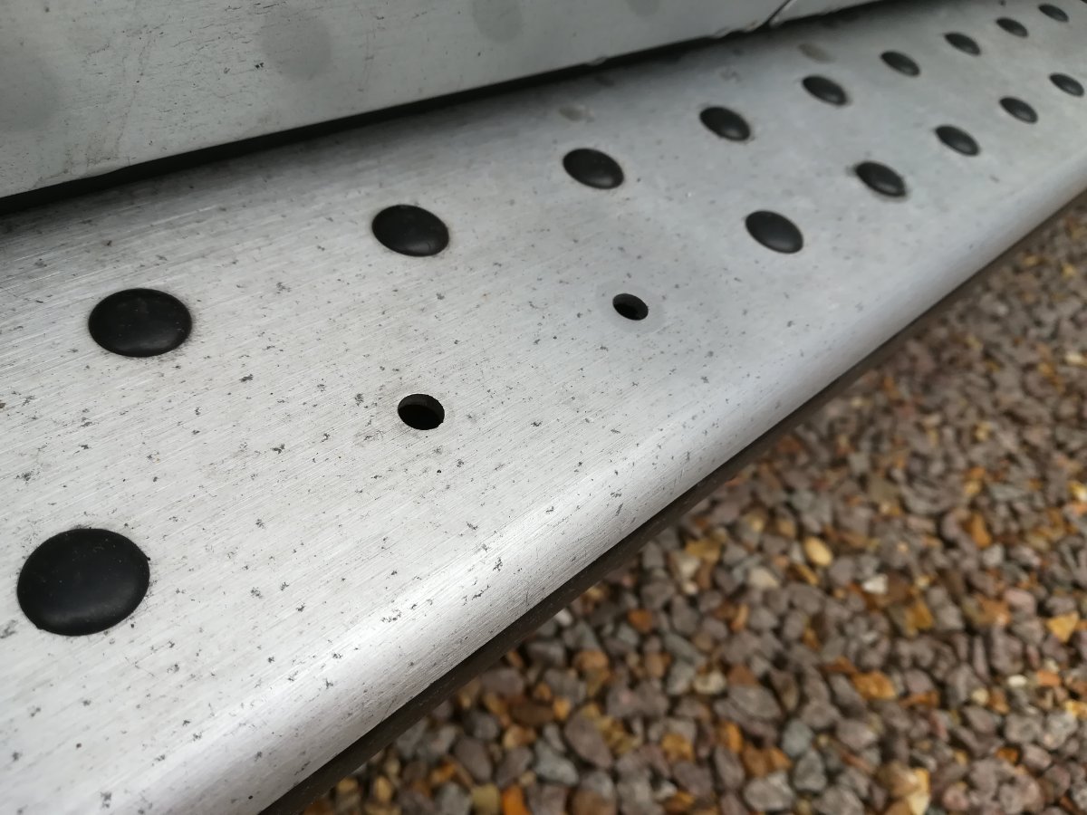

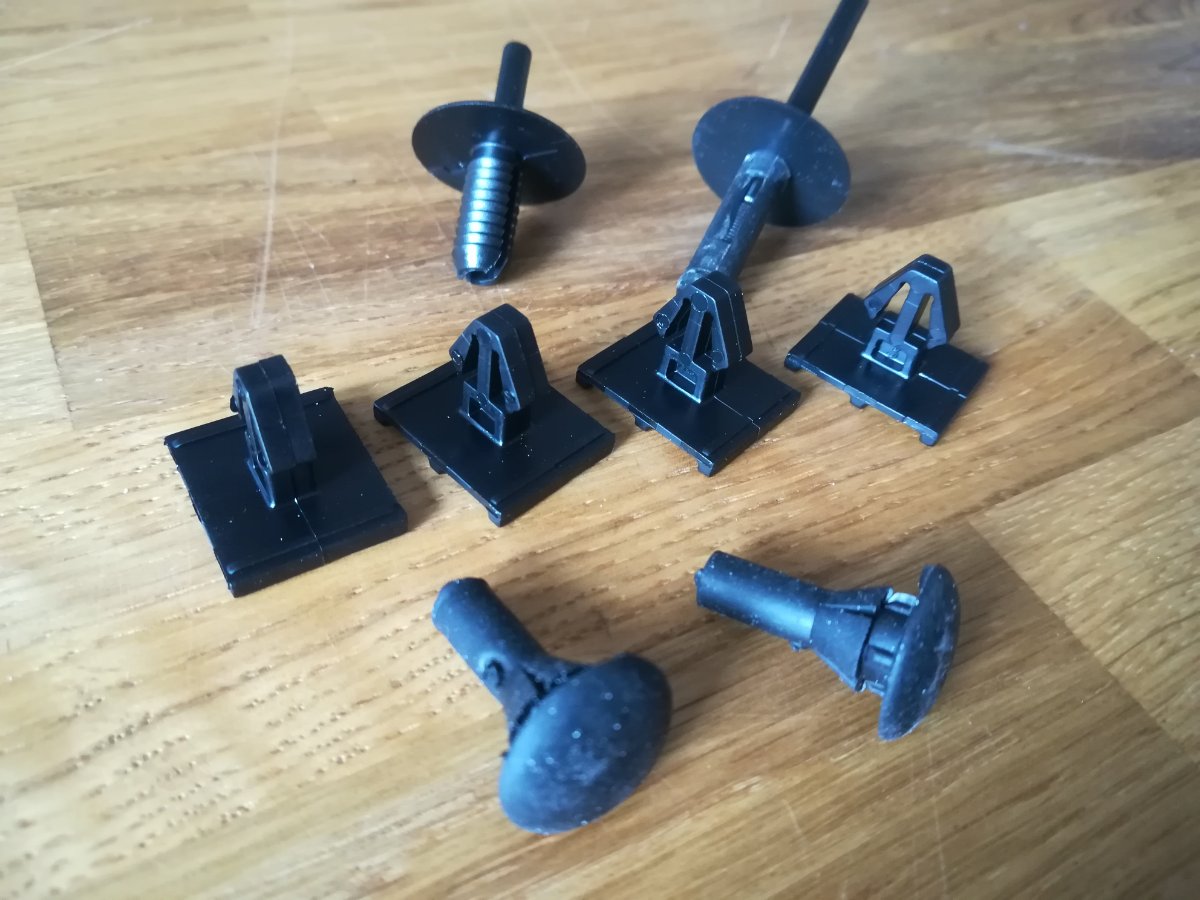

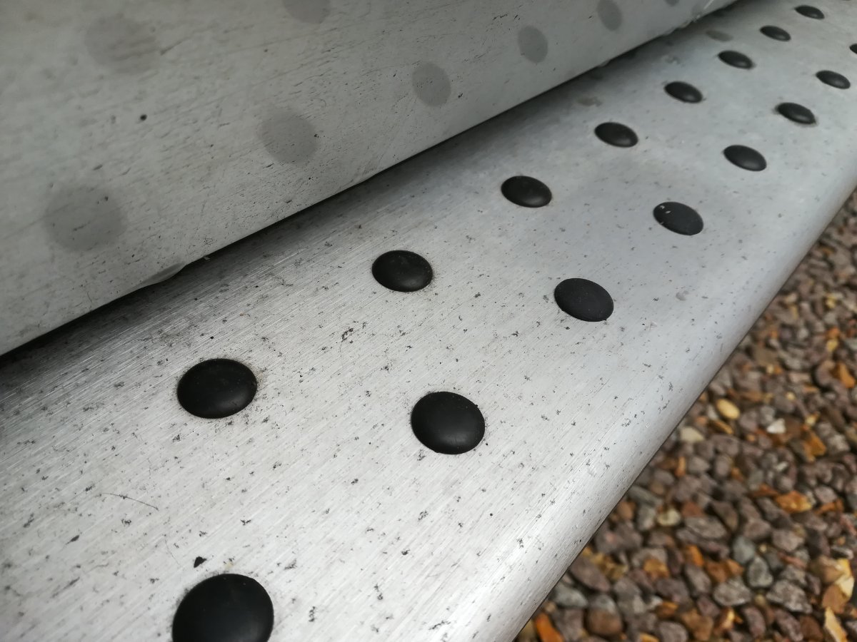

I happened to stop by Barons BMW Cambridge today to see what became of a few little bits I ordered just prior to house arrest.
Low and behold they were there and no one had bothered to post it. Anyway, New grommets in the running board. The clips I didn't need in the end.
