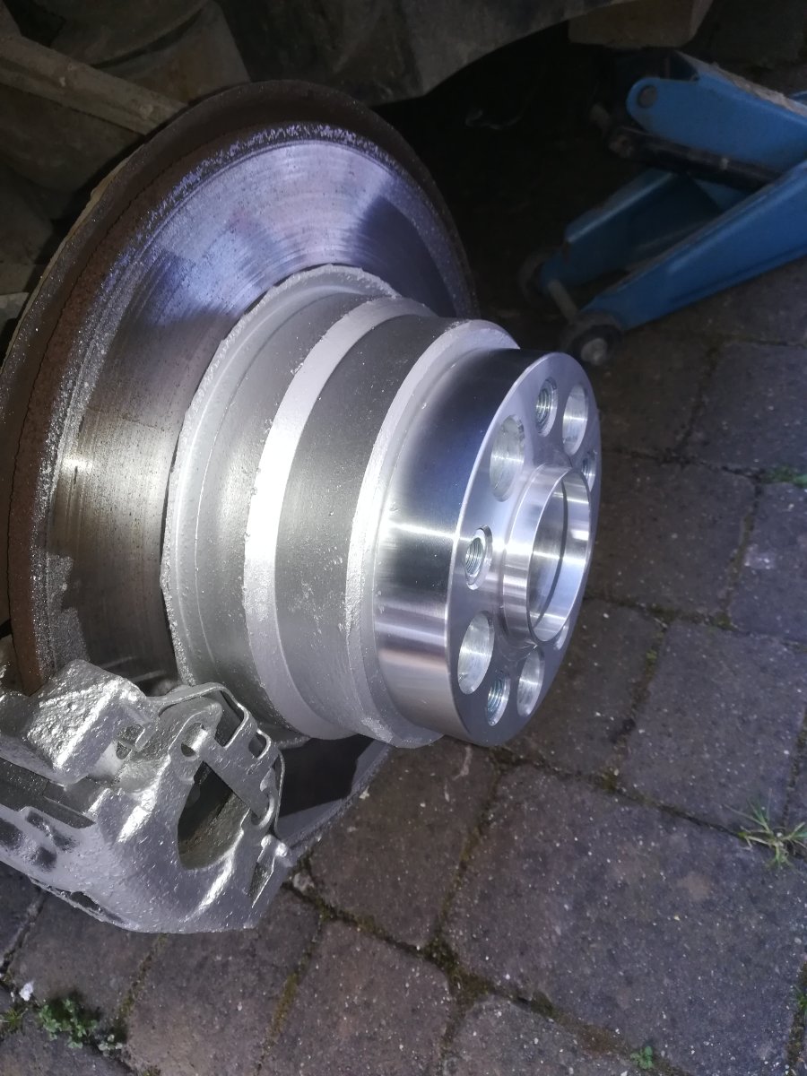

Here we go - between gardening and feeding kids I've been fiddling with the V8.
Side steps on, one rear wheel spacer and under wheel arch detailing done so far. I'll press on and do the other wheels in the next few days.

You may notice that on the running board there are two grommets missing. I have some on order for some from BMW who are shut (low and behold - 'amid fears' and 'for the safety of' blah blah)..
I snapped up some front wheel spacers off ebay but when I got them I realised that they are for an E46 so the bolts are 12mm and not 14.. New bolts on the way.

Nice work and those are fat spacers
are the hub centers the same or different to an e46 ? I think e46 ones were 72,6 mm
I did notice x5 studs are bigger .
I notice too the outside 10mm of the disc isn't getting swept , I put new front discs on a year ago and one of mine has started doing the same thing again

30mm spacers at the rear and 20mm at the front. Yes the E46 ones fit and I’m just waiting for the new bolts. You will always get a bit of a rim that is not touched by the brake pads so that’s ok.

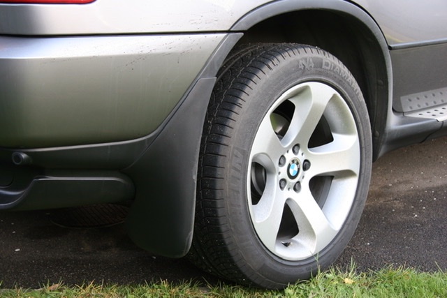

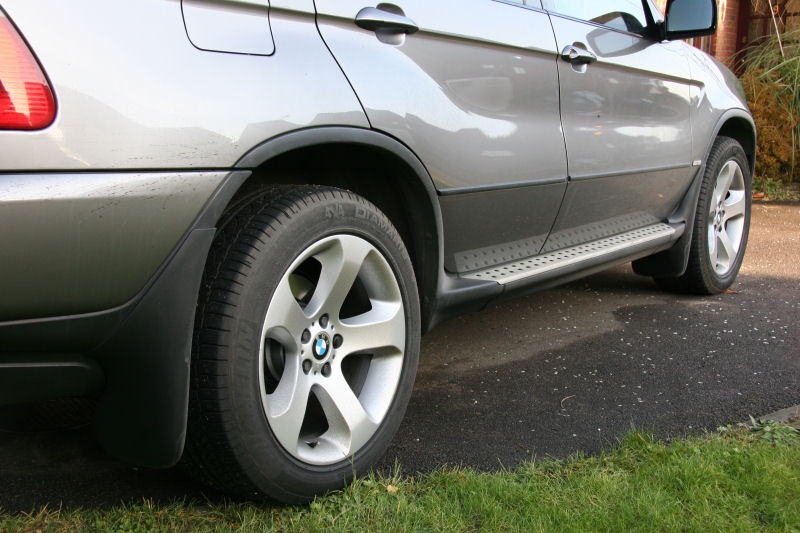

I had OEM mudflaps on my E53. I don’t have a full set of pics, but this was what I found in the archive (sold the car 9 years ago).

Ah ha! That them. In my opinion they make the vehicle look a bit more 'chunky' if you know what I mean.

They don’t to a massive amount of splatter prevention though. They help, but don’t expect a clean side, especially if you are spacing the wheels further out. They do reduce the amount of rooster tail on very wet roads though. More of use to tailgaters behind you, but still.......
