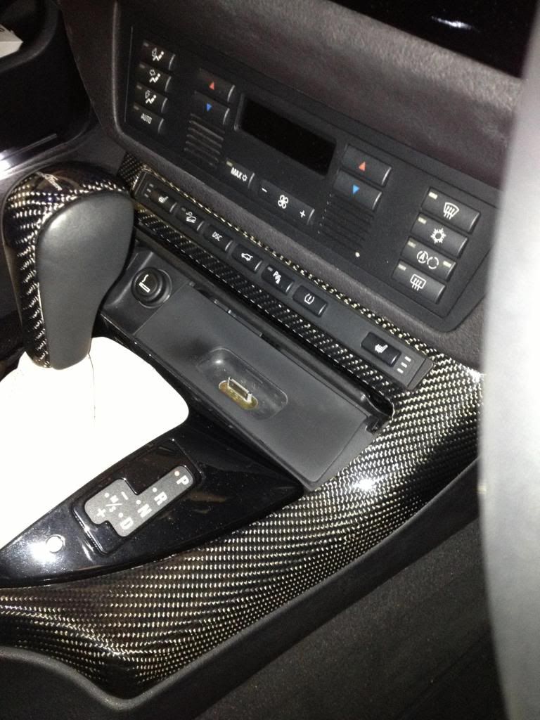

Post by Raj » Mon Feb 25, 2013 8:43 pm
[quote="MrMaloo"]
[quote="Raj"]
Nicely done but for me I went with a spec.dock
[/quote]
What's a spec.dock?
[/quote]
Here you go:
Charges the phone and has AV input into my Pioneer so can watch whatever is on the phone straight onto the screen.

Post by MrMaloo » Mon Feb 25, 2013 10:36 pm
Ah ok so works best with an aftermarket head unit? Carbon trim looks VERY cool. 8)

Post by Raj » Tue Feb 26, 2013 7:35 am
[quote="MrMaloo"]
Saw the ac schnitzer pedals on fleabay - what other AC bits have you added apart from trim,wheels and pedals?
[/quote]
Can be interfaced into the OE satnav screen (I did originally).
I've only got the AC interior trim and boot lip spoiler. My pedals are the OE jobbies and my rims are Alpina's now with BBS's for winter.
