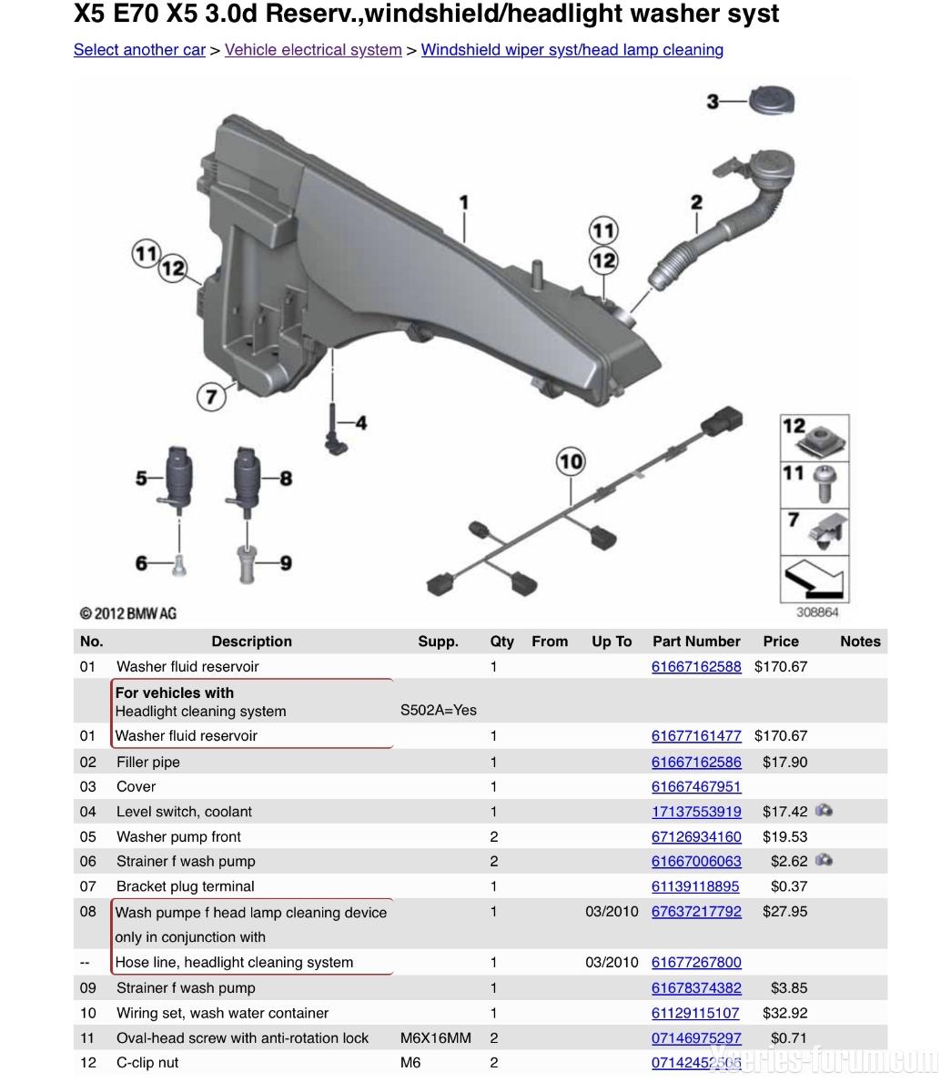

The engine you have is going to be the M57D30TÜ2 to give it the full code, and yes it’s 173kW / 232bhp. The 210kW / 282bhp engine (adds code TOP at the end) is the twin turbo 30SD or 35D before the N57 series lumps came along in 2010.
You should be able to very gently pry the covers up - the retraction spring is quite strong so beware! Often owners use the wrong fluid and they jam. Algal growth from wrong fluid is also the cause of trouble.They’re powered by water pressure, so closed by a spring. You could have a blocked or u/s pump. No pump means no pressure so nothing happens.
If I remember correctly the blasted tank is in the wing behind the arch liner.

The headlights will need to be on to operate the headlamp wash , goes 1st time then every so many goes after that, I always turned my headlights off if on to avoid operating the washers .you should hear the motor operate .

Agreed. With my E71 ownership experience i have heard the additional motor kick in, i also know it cyclical, is it every fifth or sixth pull on the washer stalk? I think its something like that. I'll try it again but not tonight.Leslie wrote: Wed Jul 02, 2025 10:36 pm The headlights will need to be on to operate the headlamp wash , goes 1st time then every so many goes after that, I always turned my headlights off if on to avoid operating them .you should hear the motor operate .

I have posted on this subject previously. Yes the tank is a bizarre shape, designed by a computer to fit into a cavity void in the osf wing. To access it, its wheel off, arch trim off, slacken the sill trim then the arch liner. About as ludicrous as accessing the DRL lightbulb.X5Sport wrote: Wed Jul 02, 2025 9:14 pm The engine you have is going to be the M57D30TÜ2 to give it the full code, and yes it’s 173kW / 232bhp. The 210kW / 282bhp engine (adds code TOP at the end) is the twin turbo 30SD or 35D before the N57 series lumps came along in 2010.
The washer bottle motors had a blue/white gel fouling them. I only use BMW fluid as past experience dictates its use. So why this blockage occurred, i dont know. This car has only one previous monied owner. All its maintenance was the supplying main dealership

I had my pumps out before for the same blockages and my tank or more likely the rear pump is leaking as its not working now and 3/4 of the tank runs out on the street over a day or so .

It transpires this car does have the headlight wash option according to BMW UK. That is now a frustration as it is not working, though im half sure i heard a pump run for a very brief moment but hasnt since. I won't be Investing the money it required to resolve this on the X6.
If i can find a worthy workshop ill consider spending but i can live without the headlamp wash. Both screen pumps are fine.
Last edited by sapphireblack on Thu Jul 03, 2025 5:12 pm, edited 2 times in total.
- Posts: 19210
Vin decoder
Part 8 here…..and yes it’s at the bottom of the reservoir.
