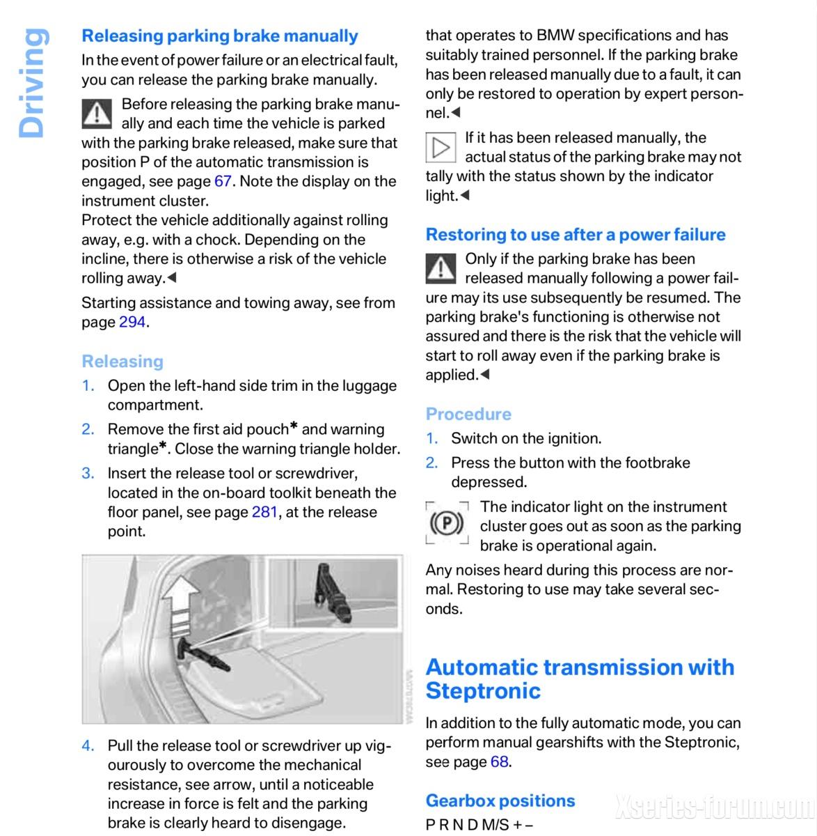

If it’s an E70 then yes the electric parking brake is a known issue. It’s usually the actuator that fails. They can be repaired, and rebuilt ones are available but don’t buy a Chinese copy or you’re likely to be back at square one soonish.
BMW will sell you a new unit at a suitably silly price. It’s also possible to use the emergency release in the left rear cubby. There’s a special tool which should be in the toolkit. It’s bright red plastic. Procedure is below.

I have read about the emergency tool, thats for releasing a stuck on brake. In this instance the car says the parking brake has failed. The switch in the centre console looks easy enough to replace. The actuator on the other hand is beyond my capabilities with having the car raised , wheels off, discs off etc.
