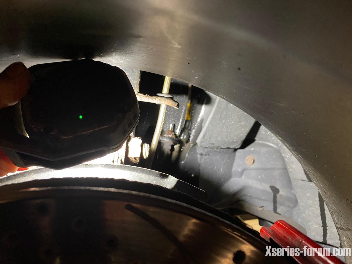

I took the X for MOT on Tuesday, didn’t even get as far as getting it on the ramp. During brake test the pedal hit the floor. The front left braided hose busted. It’s now parked at the MOT station waiting for a new hose to arrive. I have contacted the supplier to complain that although it is 8 years old it replaced a rubber pipe that was 15yo. To be fair he has asked for pics which I will take when they are replacing it. I did point out how lucky I felt that it happened at the station rather than on the way there.
This is the best I could get between wheel and arch.
Actually it’s a pic through the spokes.

Best place for it to happen :driving: I was coming up to a smallish roundabout in a little peugeot 205 with a trailer on many years ago and a cam coming towards me went right with no indicator and caught me off guard ,( there were 2 lanes go straight on and the right rarely used ) I stamped the brake hard and it braked strong initially for about 1 second just enough to not ram the other can then pedal dropped to near floor . You still have some brakes but a lot of pedal travel and only 1 diagonal circuit . The rear steel line burst before the flexi , limped on a bit but came to a steep hill and got recovered for safety.
I cant really tell from the pic but it looks like it has blown of the compression fitting where it is spannered on at the factory ( could be wrong and hard to tell)

Post by henrym3 » Fri Jan 24, 2025 11:42 am
I will have a close look when all the bits are off. I’d have been tempted to go back the the BMW rubber but the after market caliper connection is different. If it’s a hose failure it would make me loose faith.

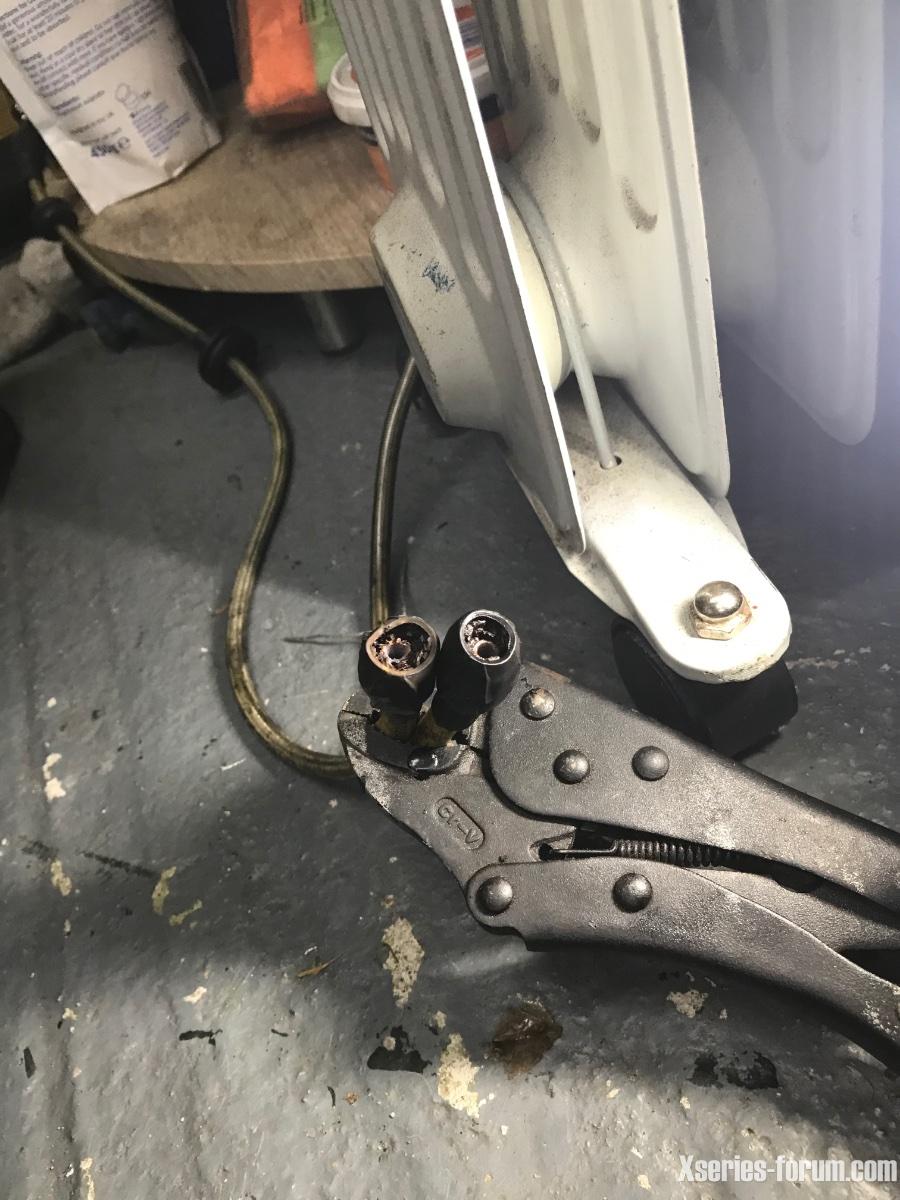

I will change the back ones when I get time. They were bought in 2017 so only 8 yo. I’ll put up some pics later of the failed one.

Post by henrym3 » Tue Feb 04, 2025 3:47 pm
I said I’d put up some pics but I’m not actually sure what I’m seeing. It seem to have failed where it connects to the metal brake pipe. I’m not sure which one of those is the one that failed as both look pretty similar. Perhaps it’s the one with the shorter internal pipe.
