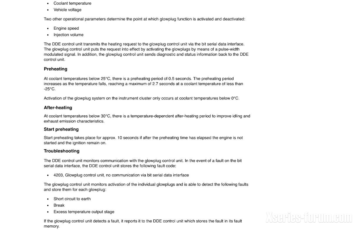

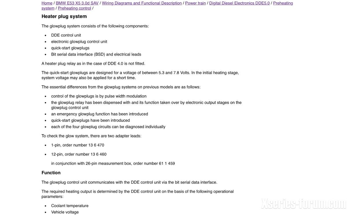

- Posts: 19210
Glow plug issue
Functional description of the system…

Still would love to know any configurations anyone’s tried. As this is the same error I had with last module and then it returned with vengeance. Worth checking resistance with the cables going to the plugs ?i.e continuity test. If there’s a break in the circuit would it give me this error. And if anyone knows which fuses I need to check I’ll have a look, and if there’s any relays that apply to this ( within the fuse boxes ) I can double check these, going to scan the codes tomorrow as I can bet they have returned

Did you check the voltage on the original plugs.
Had the wrong voltage plugs for my 320d but the plugs looked the same.

Some are 5v some 7v not sure if there any others but could be 12v ones.
