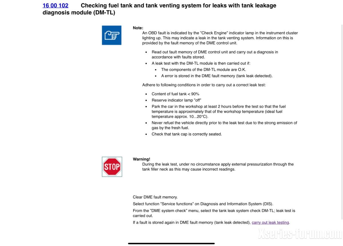

The fuel tank has a pressure control valve system built into the fuel cap. It might be that is leaking (as in not holding pressure). The only way to check that is with DIS and a special toolset that connects to it. You also have to pressurise the tank by 0.3Bar (4.2psi) and see if the pressure holds. Not possible to diy safely. Changing the fuel cap would prove/disprove it.

Technical description of petrol fuelled tank system…..
Petrol engine fuel supply systems
Fuel system
The fuel pump in the fuel tank generates pressure in the fuel system, which is set by the electronic pressure control valve to a certain level.
Tank-venting system
The tank safety valve is a closed system that is bled via a carbon canister. The carbon in the canister is stored as granules. The large surface of the granules traps the fuel vapour, that occurs in the fuel tank. The carbon canister needs to be refreshed regularly in order to be able to continue to store fuel vapour. This is done by flushing it with fresh air from the intake pipe. This process is controlled by the engine control unit.

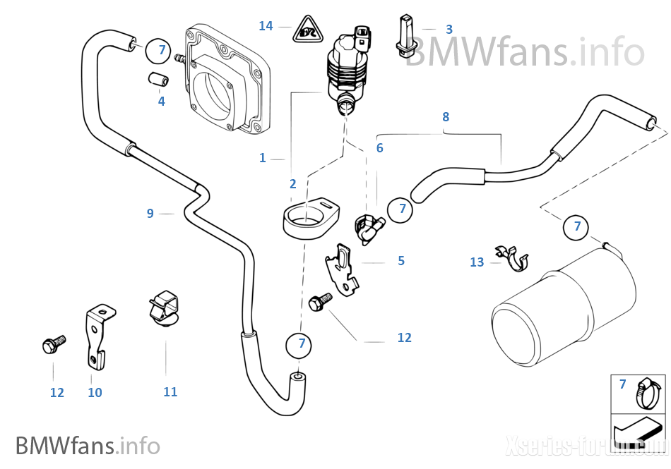

There is a fuel vent valve on the front right cylinder head (as you look at the engine) has an inlet and outlet pipe plus an electrical plug. The valve is cycled by the ECU to vent the tank fumes into the inlet manifold. Check one of those pipes isn’t disconnected from the valve or got holes. Also that the plug is in good nick, maybe needs a squirt of electrical contact cleaner. The valve could be knackered but that should show on diagnostics. looking at X5Sport answer I could be talking s%!t.

I am talking about item 1

Ok so I’ve checked that valve and it’s ok. Under the rear seat is clean and no odour. The filler cap however, was wet around the rubber seal. I haven’t used the car since yesterday. Maybe it’s worn out? I’ve cleaned it all up and put it back so we will see.

I looked up checking the valve and it should show 28 Ohms resistance +/- 1
