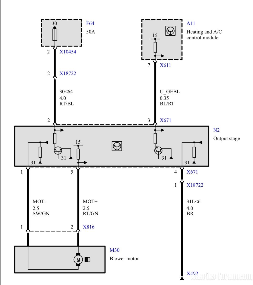

The fan power connector is on the fan itself and uses a 0.5 to 8V feed from the rocker switch. Colour code is SW/GN (Mot-) and RT/GN (Mot+). Ground is via the output controller so don’t ground the motor feed as it is done in the control unit. The control point is on connector: X671 (on all engine versions).
It is controlled from the AC control panel so the fault may be with that module.

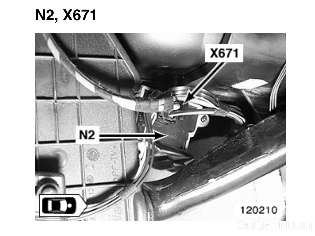

The X671 I assume is the hedgehog that has 5 wires going in/out. The red has battery voltage brown is earth, can’t remember colours now but 1 moved between 0 fan off and 8v fan on full. I would be very reluctant to poke voltage at any of the wires to check if the fan runs. Looks like it’s dash out and I’d feel more comfortable doing a continuity check when I can view the fan connections. I watched a utube videos where they poke 12v at the fan once the plug is disconnected so to that end I’ll not buy anything till I can confirm one way or another. No hurry this mild weather doesn’t need hot or cold air so I have a feeling it will be put off for a while.

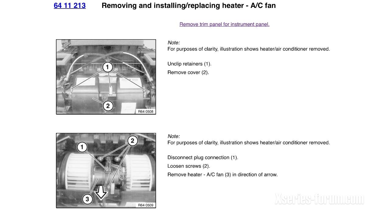

The voltage seems right. The final connection is on top of the fan unit and as you suspect that is a dash out job. The connection is to the hedgehog (Final/Output Stage Resistor). Input side is a BL/RT (I think BLUE with a Red tracer) wire onto Pin 3 (0.5-8V DC). Output as above Pins 5 (Mot+), Pin 1 for return (Mot-). Power feed to the FSR unit is RED with a Blue tracer
All of this lot have to be carried out:
+ Disconnect battery negative lead.
+ Remove both panels for front roof pillar.
+ Remove light switch unit.
+ Remove complete instrument carrier.
+ Remove fixture for steering column switch.
+ Remove centre fresh air grill.
+ Remove radio receiver.
+ Remove airbag module on passenger side.
+ Remove centre console.
+ Remove lower right trim from instrument panel.
+ Remove left glovebox.
+ Remove all clipped finishers (decorative strips on panel for instrument panel).
Not sure about heat as the circuit would be incomplete so no current flow. You could try poking a long Nylon cable tie through the centre air vent to see if you can move the fan in case it’s stuck for some reason. The power goes to Plug 1 below.
