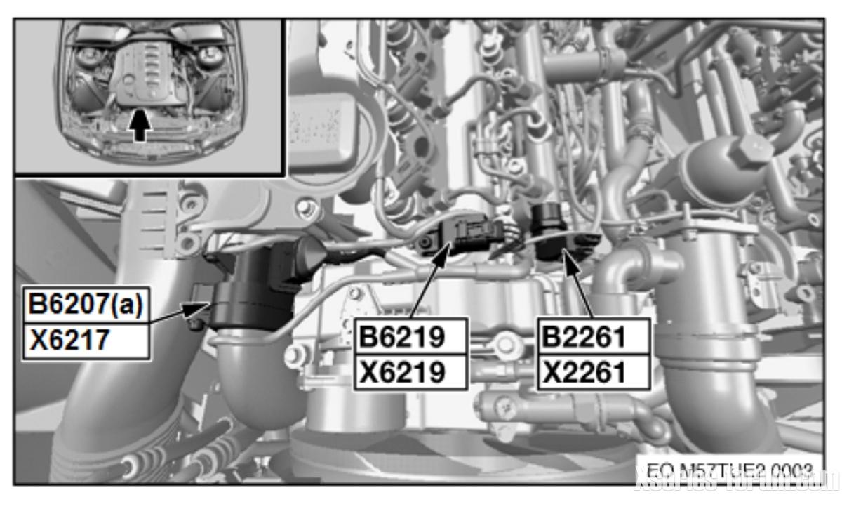

Hi. Reconditioned injectors. Not sure where the camshaft sensor is on the E70.
- Posts: 19087
E70 crank no start when warm
Camshaft speed sensor B6219…..

It should be throwing codes….
Hall sensor, camshaft
The camshaft Hall-effect sensor is mounted at the top front of the cylinder head cover. A rectangular lobe which moves past the Hall-effect sensor is located at the front of the camshaft. The DDE control unit evaluates the resulting voltage signal (one square-wave signal per camshaft revolution). This signal is used for synchronization purposes:
Synchronization sequence:
when the engine is started, the DDE control unit detects from the camshaft signal whether a cylinder is at TDC on the compression or exhaust stroke. At the same time, the crankshaft sensor signal must be detected in the correct sequence.
Only if those signals are correctly detected can the DDE control unit activate the correct injector at the correct time.
Engine start is not possible without synchronization!

It's Definately worth changing the cam sensor just to see as its not expensive and it certainly gives hot starting issues if faulty, sound like an expensive nightmare after that parts list.

Update: the camshaft position sensor appears to have emilimated the starting issues. Thanks guys. But why were there no fault codes being read by the various diagnostic tools? Not that it matters now coz the car seems to start as it should. Thanks again.
