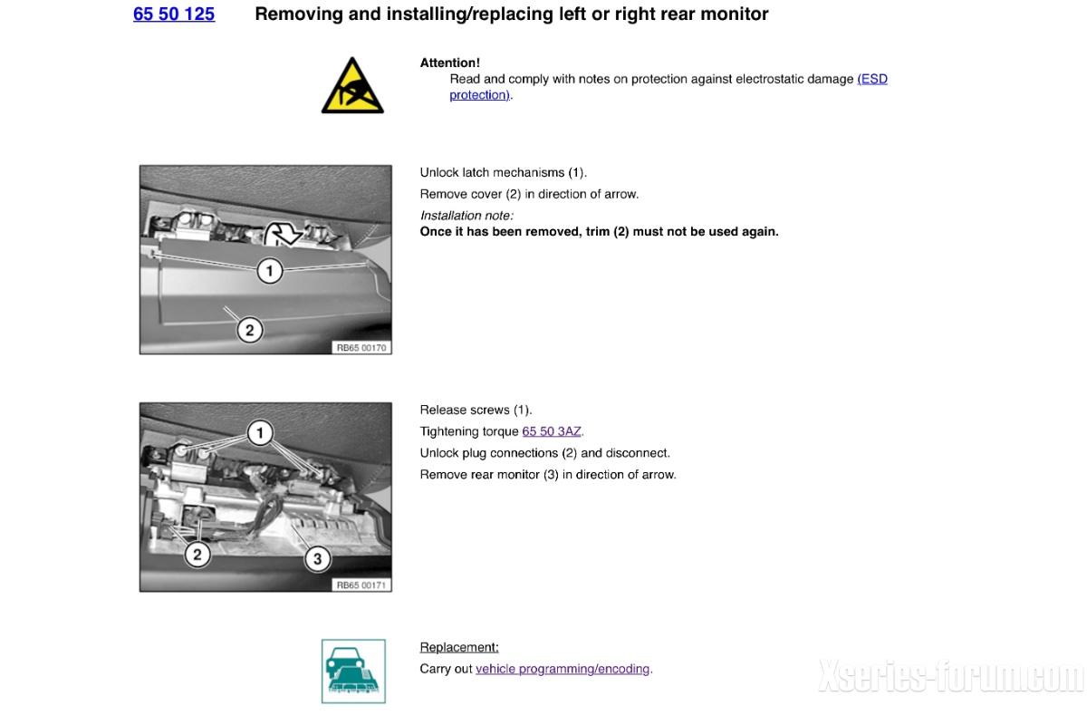

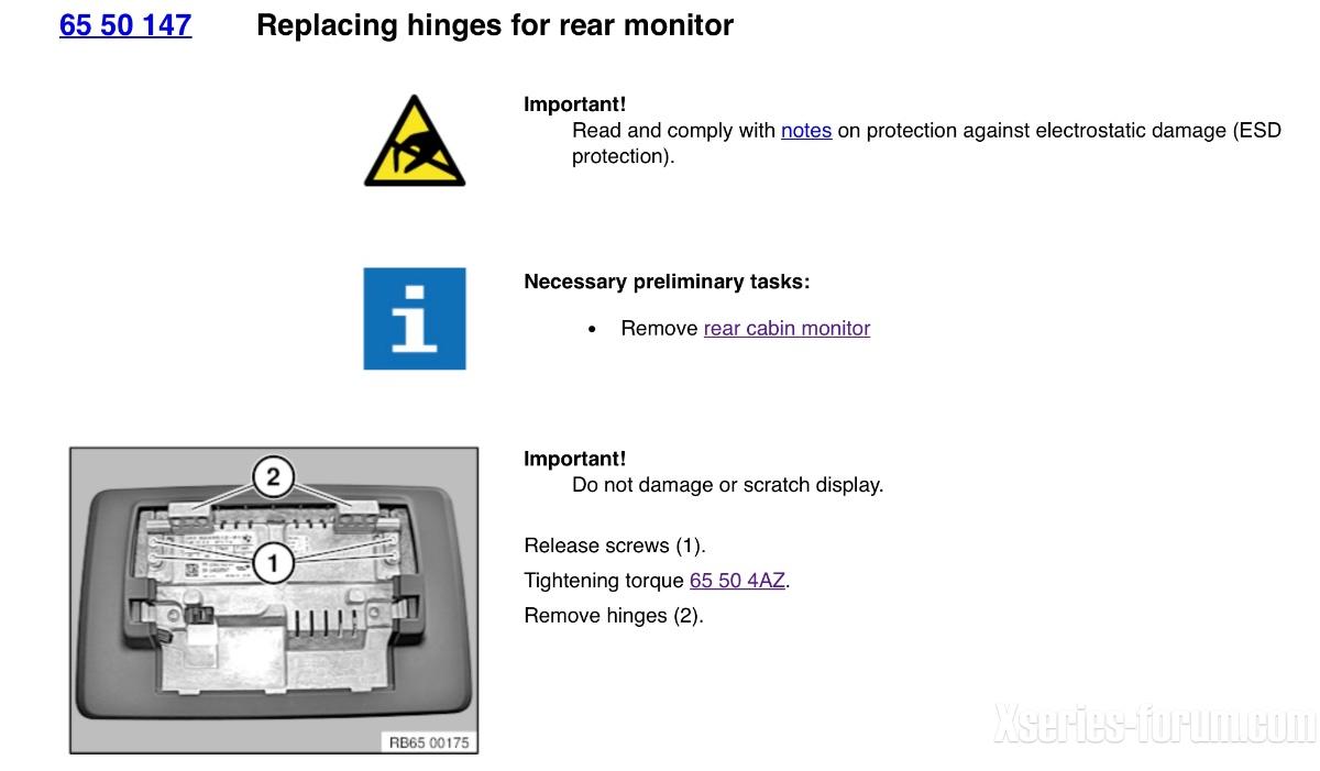

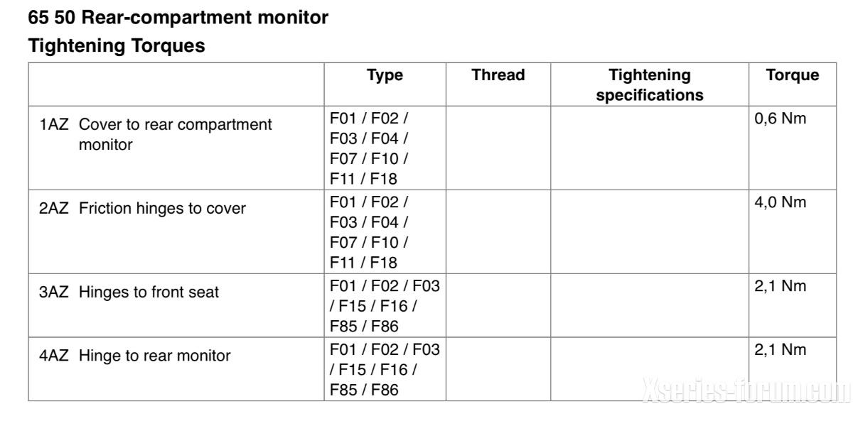

These help at all? Doesn’t say anything about taking the seat to bits, however it depends upon which part is busted. Make sure you have an anti-static wrist strap bonded to the car though.

If it’s the hinges, RealOEM shows these:
https://www.realoem.com/bmw/enUS/showpa ... Id=65_2652

Absolutely brilliant - that really helps, thank you.
I'll see if I can remove the screen first, and then I'll confirm hinge damage. If I can replace hinges and that solves it, I'll be a very happy man. I'm not back in the UK until the end of the month so won't be able to do it until then but will look forward to giving it a shot.
Will look into a suitable torque drive, unless you have any recommendations on that too?

Those torque settings are pretty much hand tightness. There are 1-10Nm drivers available, but they’re expensive, and most look like normal screwdrivers with a gauge on the handle.
As long as you don’t ‘Go Gorilla’ on them you’ll be fine and I’ll bet BMW Techs will just use a screwdriver. :D
