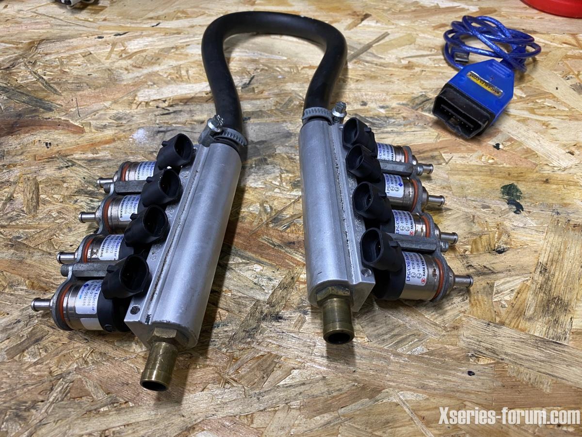

Been having a problem for a while now. So drive of and when car gets to temperature to switch over the engine dies. Switch gas off and engine picks up and drives normal but now have a warning light on. Took it to Dorset LPG for a diagnostics and turns out 4 of the injectors are leaking 1 quite badly so therefore the system hasn’t got enough pressure to squirt when required. Remedy is 4 new injectors but working on the principle the others probably aren’t far behind I’m going to replace them all. They are Hanna injectors and are £135 for the 8 that is if I can find somewhere that isn’t out of stock. They will have done about 130k. Not the only fault I’ve got atm. Seem to be having a bad patch. As the Alpina is still sitting on the driveway waiting for the accident repair people to come and get it I’ve had to get the VW out as the daily.

I thought that, quite surprised they are around £17 each. Fingers crossed. Got all the phone numbers lined up to call in the morning.

Injectors arrived today, easy to fit, warmed up the engine and it switched over fine, idles great drives well but after a few miles the management light came on, maybe it needs to learn again.
