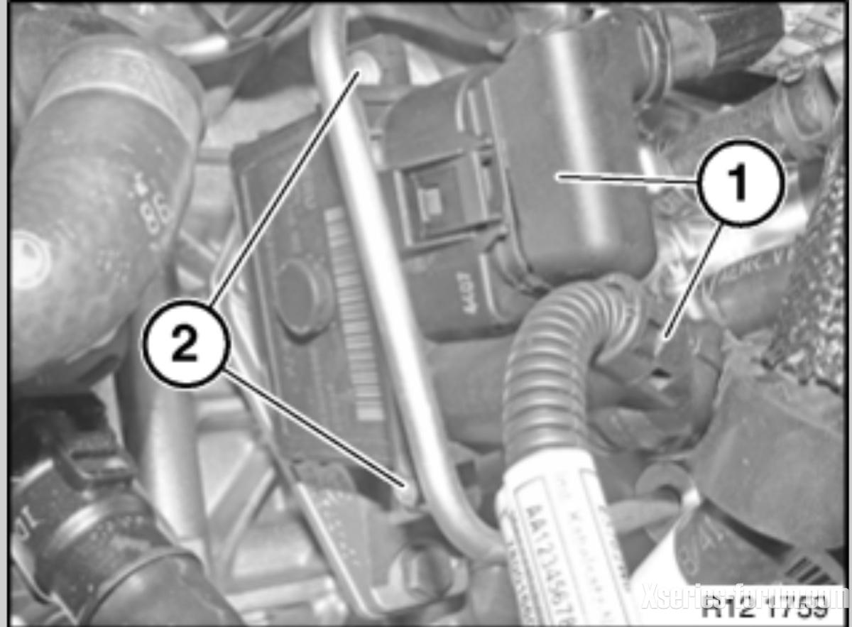

Pre-heating control module is below the air intake plenum - which needs to be removed first.
To change the module, remove electrical connectors (1) and then undo the two screws holding it in place (2)
Has the module failed or the glowplugs (or both)? Previous bitter experience advises any glowplug change to also include the preheat controller module as these usually fail weeks after glowplugs get changed.
The module is usually made by BERU.

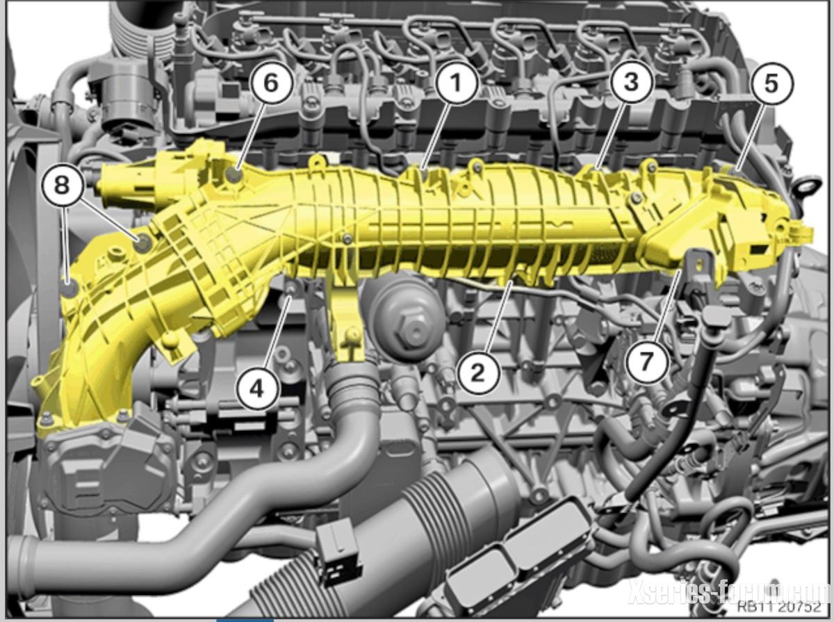

The intake plenum is the big yellow thing below, with the module where ‘7’ is. That’s the tightening sequence for the plenum itself. Quite a lot of stuff has to come off unless you can get to it from below. I’ve got a feeling the alternator is in the way as well. It’s been a while since I looked, but I remember changing the oil filter needed care to avoid metal tools touching live wires!
