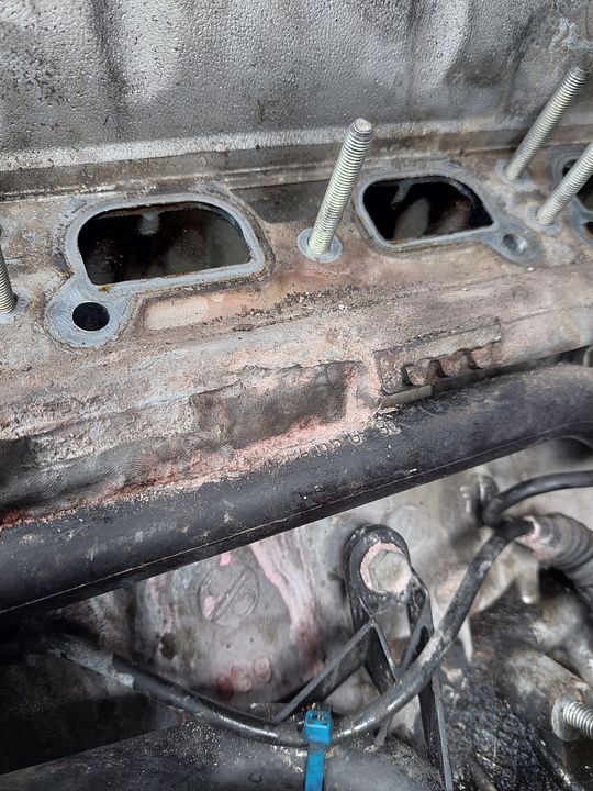

There seemed to be some kind of chemical metal had been applied to the area of the head just abou the hard coolant hose. I could also see that coolant had been running sown this side of the head as well.
So obviously this rang alarm bells as firstly i was asking, why was coolant leaking from the head, and it meant that someone had been under the bonnet before me. So i decided to remove the head to see whats going on and i found this...
What on earlth would cause the coolant channel to oxplode outwards like that? How could there be so much pressure in there to cause that? Anyway i sourced a replacement head, together with new head bolts, and a rebuild kit fo the Vanos and fitted those.

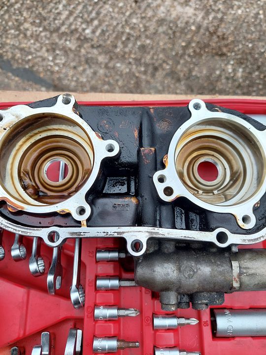

I also noticed upon stripping the engine that everything below the inlet manifold was covered in a fine film of oil and the pan at the bottom was covered in it, and by the looks of things, it had been dripping down there for a while, but upon inspecting all the normal gasket and seals, there were no obvious signs of a leak. Im now puzzled at this point.

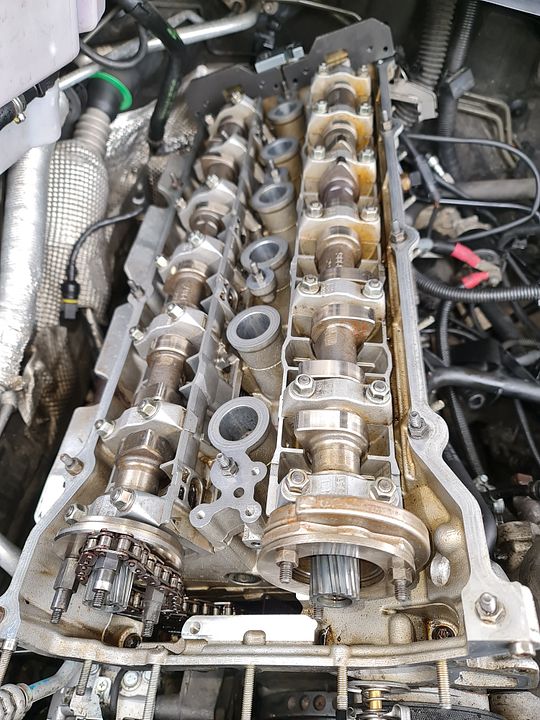

So head removed and replacement is refitted together with rebuilt vanos..
...and everything was back together including all new hoses and PCV valve, and nothning at all changed. It was running just the same as before. The only difference this time is that prior to changing the head it was consistantly bad all the time. Now it seems to vary. Sometimes the lumpiness is only slight and at other times its virtually undrivable, but it never stops.

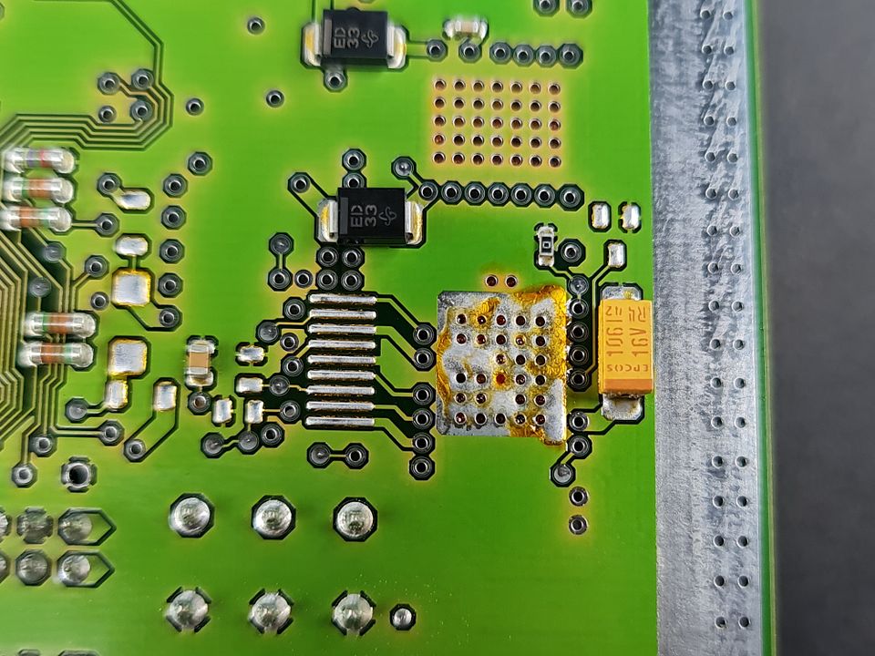

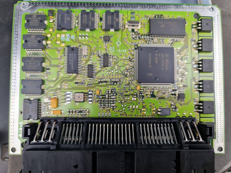

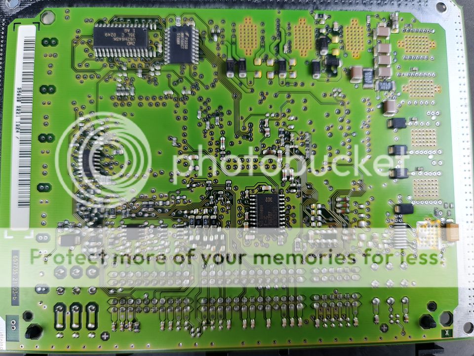

Following on from all of this with no answers, someone has suggested to me that this could all be casused by a faulty ECU. I thought this was unlikely because i dont see how a faulty ECU could explain the whining noise and the oil loss, and i have never had an EML light come on. But i decided to investigate by actually having a look at the ECU, So i located it and took it out to have a look inside..
and from the top all looked ok..
and looking at the underside of the pcb, all looked ok until i noticed thison the left
Now this might be something or it sould be nothing but i thought i d put it on here anyway to see what people think.

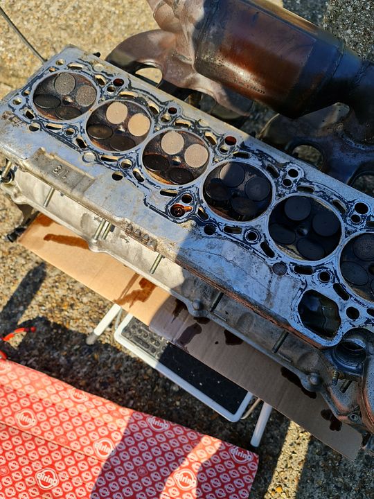

Hard to tell from the pictures, but were all the valves the same across all 6? What I mean is, colour of each valve common? It looks as if three sets are darker in colour. Might just be the lighting though :)
Before fitting the head, did you check the new head and original block for flatness? That kind of cracking could result from a twist if a previous owner failed to follow tightening rules and sequence. Could also be down to a coolant loss event causing overheating.
The inside of the ECU looks like normal flow soldering to me. Solder paste is applied from a mask, components placed (by machine) on top and the board goes through an oven that melts the solder and bonds everything. I don’t think anything is missing, that patch has never had anything soldered to it.

I’ve never seen a BMW head do that either! I don’t think I’ve ever seen that kind of damage on this forum. I’ve seen iron heads crack, but that’s only if it’s been run waaaayy over temp and run dry.

Send the ecu away for testing it wont fix the oil loss or noise but it may well be the cause of the misfire , you simply cannot tell if its any good by looking at it The head damage was most likely a frost crack due to low antifreeze and random low coolant warnings on start up are just the senor is bad or dirty . Some right bodger has been there before though to do that :headbang:

Well, the replacement ECU, EWS and all the bits has been installed, and i suspected that the MAF could have been damaged by all the backfiring that was going on previously, so i borrowed a known working VDO unit from a friend and low and behold.....the car runs perfectly. No wobbling, missfiring and no more numerous warning lights about anything and everything.
Looks like my gamble regarding the ECU paid off, on this occasion anyway. Just ordered a new VDO unit from AUTODOC in germany and itll be here in a few days, then hopefully thats my m54 Headache over.....for a while anyway.
