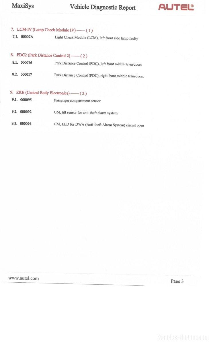

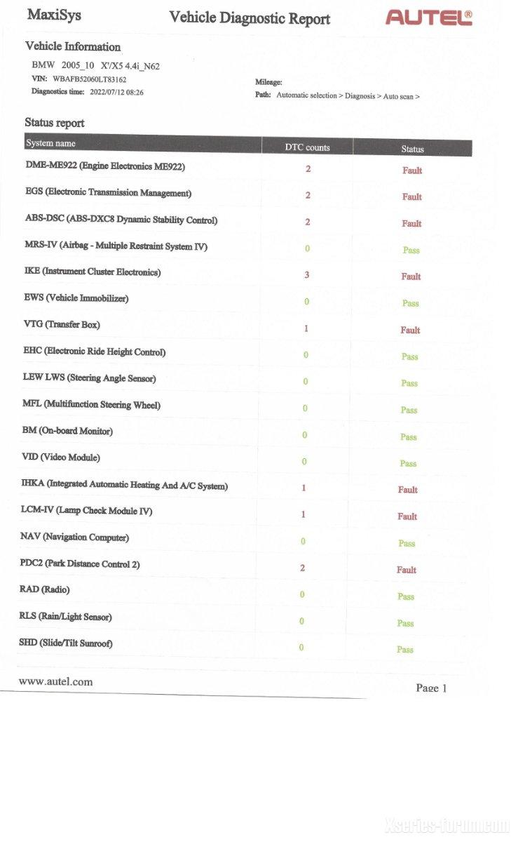

Thanks for the feedback.
I have attached the full report. Does this have the detail and accuracy needed?
These are also the dashboard lights that show when going into safe mode.
Next steps?
Next steps?

I think the ‘absent’ errors are those stored in memory from previous. If the error code log is cleared and they return then those one are ‘present’ and still triggering.
DME looks like one of the thermostats is stuck - probably open. Common fault so the engine runs cooler. That wouldn’t cause a gear problem though.
I get the Aux pump error on mine, always have and it just means the Aux Heating isn’t working…..it isn’t fitted in my case.
It could be an oil pressure issue within the box itself once it warms up. Hard to say but things to look at would be the box itself (clutch or brake packs), torque converter, transfer box.
If it’s had a transmission oil change, what state (colour/smell) was it in? Dark, burnt smelling oil means trouble within the box itself. The Mechatronics unit is just the brain controlling the hydraulics.

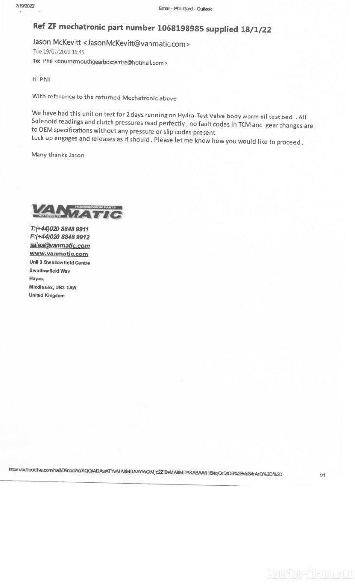

Thanks for the update.
The position now is that changing the mechatronics has made no difference, same faults are coming up.
The car is still with the garage. They have recommended the change to the mechatronics but its obviously £2k wasted.
Whose liability is it now when they came back and say new or repaired gearbox?

Has anyone does a trans fluid service on it? That would be my first option then go from there. That's experience talking too.. Yes it may be £300 but if it works then it's cheaper than £2k for a trans rebuild and only £300 more if it does need a trans rebuild. My logic seems a bit odd I know but that's the way to go in my opinion.
