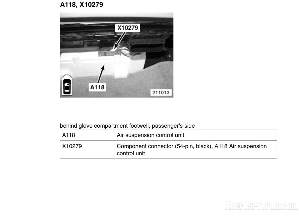

I am wondering where the control modile lives...
Anybody know ?

- Posts: 19190
Saggy Rear Air Suspension D-Sport

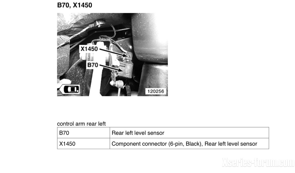

Should be here:
Is the level sensor OK on that side?

Many thanks chap.
I have a spare sensor for that corner, So will swap that out tomorrow too.
Have a great weekend.
