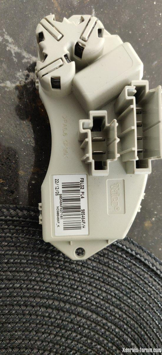

Thanks for the advice guys, it was the blower regulator. It's behind the glove box and attached to the blower. Took about 45mins with lots of F & C words.
It's awkward to take out and put back in and if you got back problems I'd stay clear.
I've attached the part in question for future references should anyone need one.

Glad you found it.
Had me worried then a bm without a hedgehog lol.
