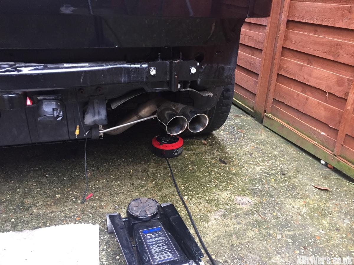

Does that include interest in after market exhausts as well, I have a Magnaflow fitted.

+1 on details, 50mm passengers side 55mm drivers side to cats, 55 mm out of cats to resonator. There was some dispute as to whether the resonator had x pipes, when mine were removed they definitely did NOT. The Magnaflow does have x pipes. Then 2 small resonators but no back boxes as you can see in the picture above. Sounds more V8 at idle.No drone, I didn’t notice any more interior noise. Only problem I’ve had was due to the fact that there were no joints. Had to cut near cats and fit a join because of removing the rear subframe.
