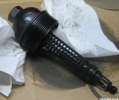

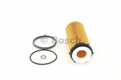

I have attached a picture of the filter type which shows a standard end and the other end with a plastic ring with notches and rubber seat.
The pther thing that confused me is I have scoured the internet and cannot find a picture or video of any X5 with the same oil filter housing as mine. The thread on mine is inside the housing cover where as the rest seem to be on the outside, pictures attached.
Any help would be great an put my mind at ease.

I use Mann filters on mine and I’m pretty sure the rubber seal is at the bottom - as in not the cap end. The other way round allows oil to get from the inlet to the outlet without going through the filter which is force fed up the centre, hence having the seal. The filter pushes up inside the cap. I have the same fitting as you. The other type is (I think) used on the M57 engines and we have N57 series. Certainly my 2005 E53 had that type as does our (now stored) E46, both equipped with M57 3.0L diesel engines.

Thats put my mind at ease. I know what you men now with the end of the filter that has the white rubber seal being correctly placed on the filter holder at the opposite end of the cap so it seals the bottom allowing the oil to be forced up through the centre.X5Sport wrote: Mon Oct 12, 2020 4:27 pm I use Mann filters on mine and I’m pretty sure the rubber seal is at the bottom - as in not the cap end. The other way round allows oil to get from the inlet to the outlet without going through the filter which is force fed up the centre, hence having the seal. The filter pushes up inside the cap. I have the same fitting as you. The other type is (I think) used on the M57 engines and we have N57 series. Certainly my 2005 E53 had that type as does our (now stored) E46, both equipped with M57 3.0L diesel engines.
Thanks for your help.
