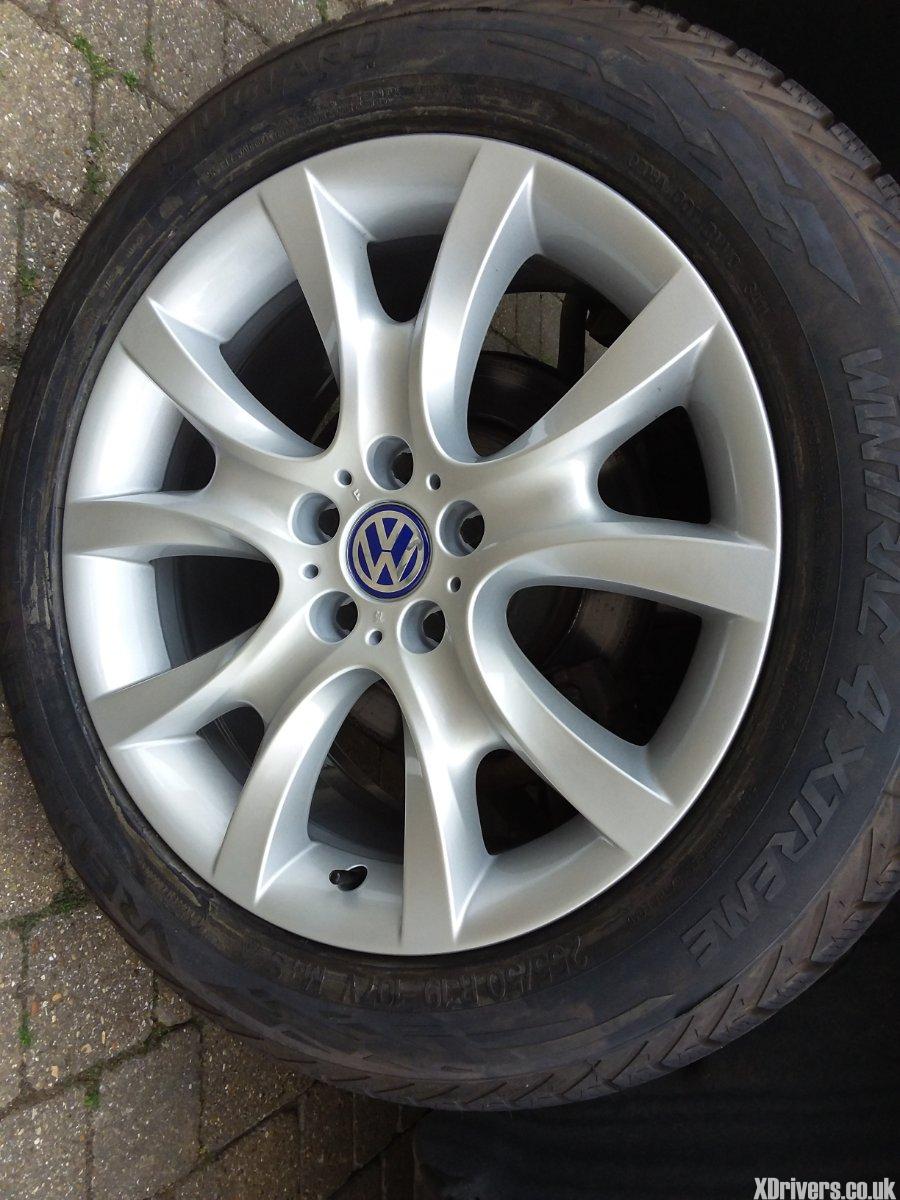

I think your experience of powder coating is unusual. When I've had such work done, i can choose matt, satin or gloss finishes. The work has always been exemplary too.
My surplus X6 winter wheels, now bolted onto a non BMW, were tidy but i had three refurbished recently in powder coat and there is literally no visual difference to the original BMW painted wheel.
Perhaps standards vary but it would be powder coating for me every time, carried out by a recommended business.

Post by sapphireblack » Sat Aug 08, 2020 7:09 am
These are standard BMW silver finish, in powdercoat.

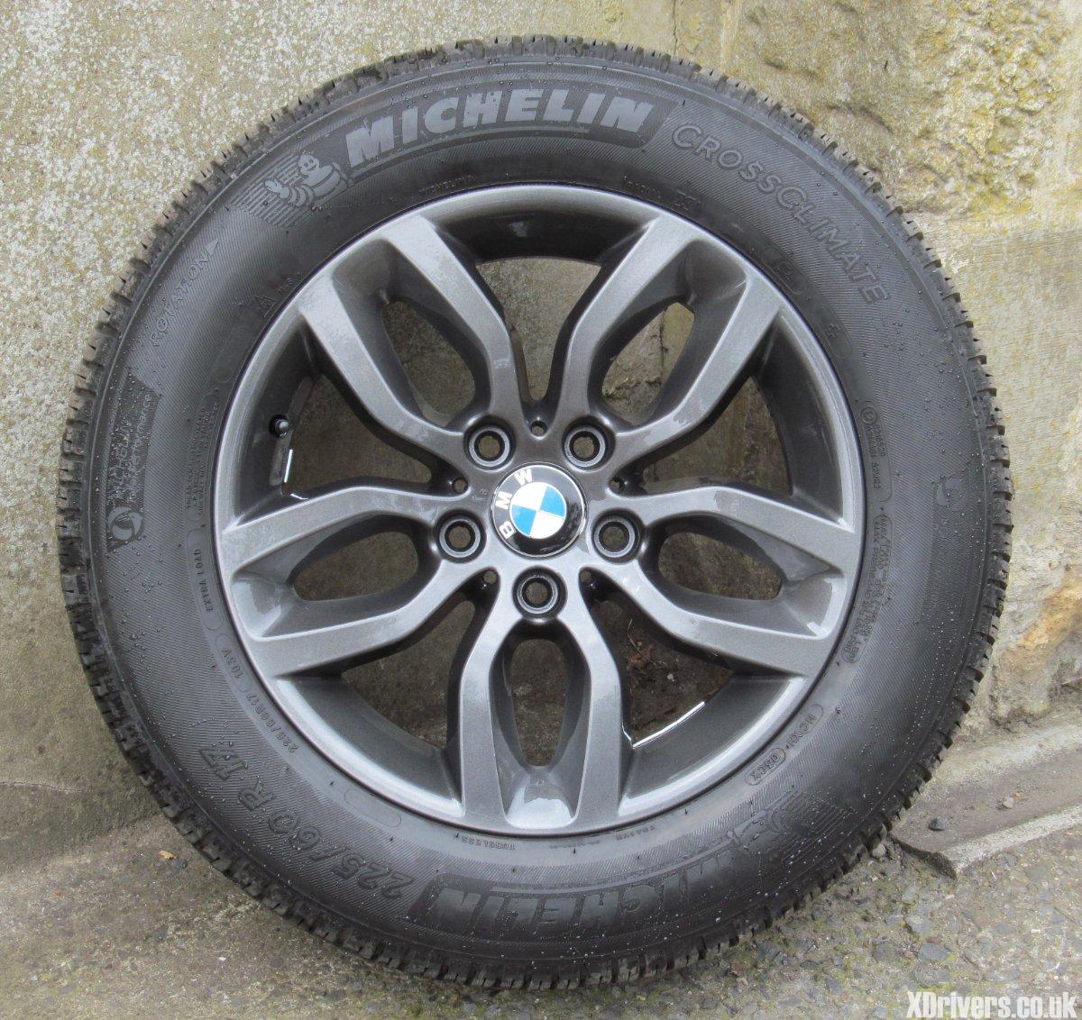

Post by StuBeeDoo » Sat Aug 08, 2020 8:11 am
sapphireblack wrote: Sat Aug 08, 2020 7:09 amThese are standard BMW silver finish, in powdercoat.
I'll take a close-up image of one of mine tomorrow, when I take them back off.
Posts: 898
Post by StuBeeDoo » Sun Aug 09, 2020 12:22 pm
StuBeeDoo wrote: Sat Aug 08, 2020 8:11 am
This is one of mine, taken in overcast light. TBF, the picture isn't representative, my eyes see them quite a bit darker than this - almost as black as the tyre. (If you've seen an advert for a BMW in Deep Sea Blue and then gone to look at the car, you may have found that the car is quite a bit darker than the photos in the advert make it look - it happened to me several times)
Alan Gunn wrote:To me any darker colour looks too shiny/glossy i prefer the normal silver/grey.
I know what you mean, Alan. With hindsight maybe I should have had them done satin rather than gloss. :( With that much gloss, I find them too "bling".

Post by sapphireblack » Mon Aug 10, 2020 5:44 am
Anthracite is a multi-colour like all others. When i first put the 4.6is wheels on my E53 they were the lightest option of anthracite available. Lepsons in Gillingham Kent did those and they were very nice, imo
Posts: 898
Post by StuBeeDoo » Mon Aug 10, 2020 5:25 pm
sapphireblack wrote: Mon Aug 10, 2020 5:44 amAnthracite is a multi-colour like all others.
Does my image look anthracite to you as well?? I'm glad it's not just me. I was under the impression that Gunmetal was more like half-way between your BMW/VW one and mine.
