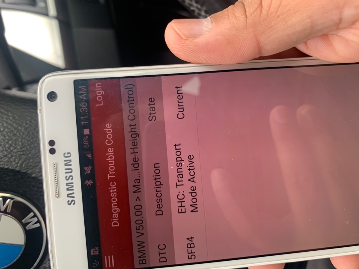

Post by b21playa » Fri Jun 12, 2020 11:05 pm
Attached
Posts: 19190
Re: Air suspension
Post by X5Sport » Sat Jun 13, 2020 9:06 am
It definitely should not be in Transport Mode. That’s only used when the car is being shipped from the factory to Dealers.
b21playa
Posts: 87
Joined: Wed Nov 03, 2010 9:00 am
Re: Air suspension
Post by b21playa » Sat Jun 13, 2020 9:13 am
It’s weird as I never put it in that, and only 1 side sagged
Posts: 19190
Re: Air suspension
Post by X5Sport » Sat Jun 13, 2020 10:15 am
Just occasionally these cars do this. It can be caused by a flat or dying battery. The computer gets itself in a tizzy and resets to transport mode. Does your tool allow you to make changes? If so then it’s just a function change to turn it off again.

Post by b21playa » Sat Jun 13, 2020 11:15 am
I reset the module and the code has gone
