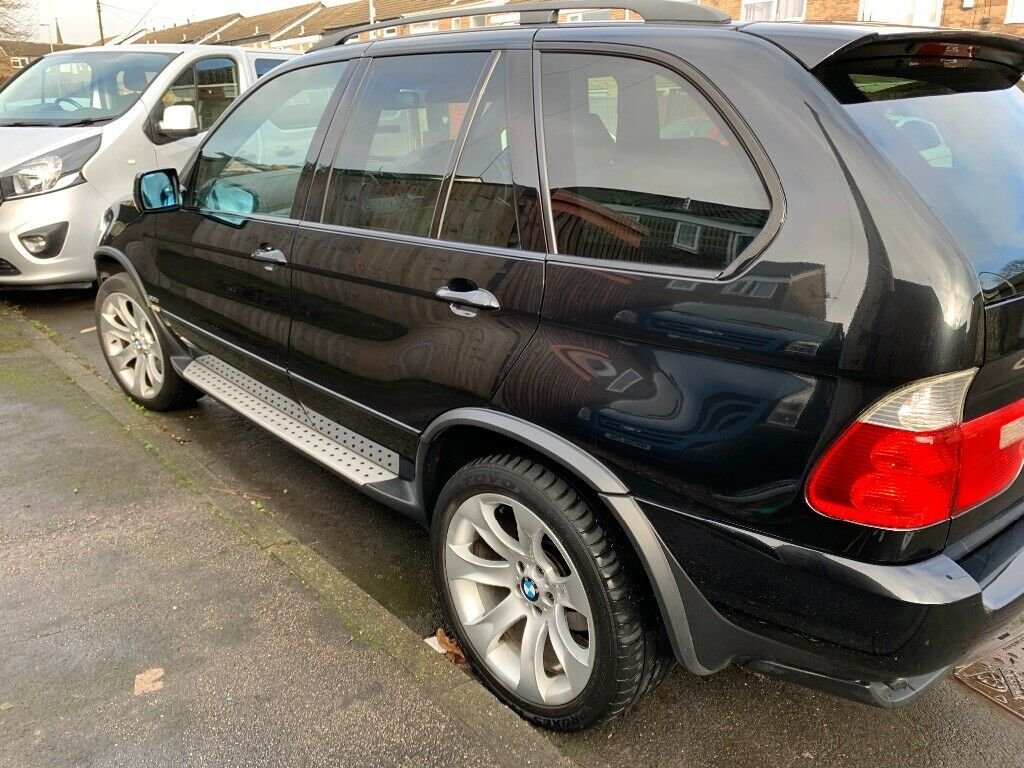

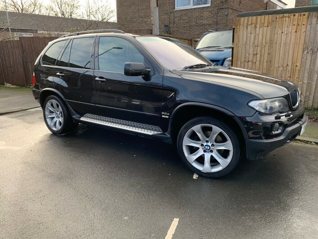

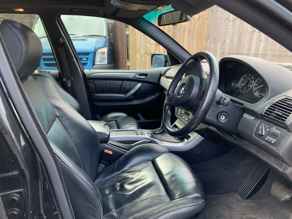

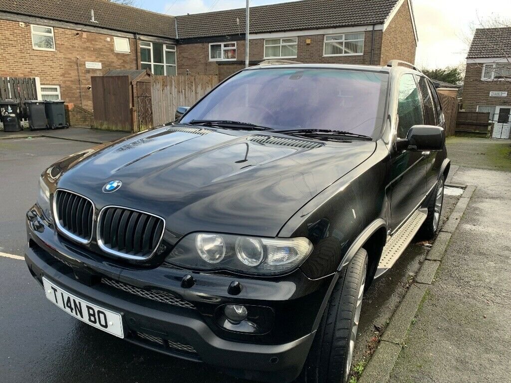

I recently bought a 2006 E35 3.0d with 130K with service history, 3 kets etc. See pictures (these are from the person advert):
It has full electric memory heated seats, heated steering wheel, fully working pan roof, factory 20 inch wheels, working parking sensors, functional Tv & sat nav.... so a pretty good spec. The condition of the car is excellent, both inside & out.
