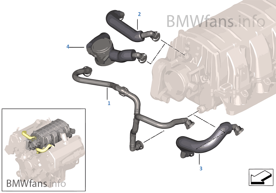

Thanks. What do you classify as PCV ?
Posts: 1952
Re: 4.8 white smoke
Post by henrym3 » Tue Feb 25, 2020 8:40 pm
This is the PCV
Also have you got any oil leaks, even minor. If you have an oil leak then you have a vacuum leak
