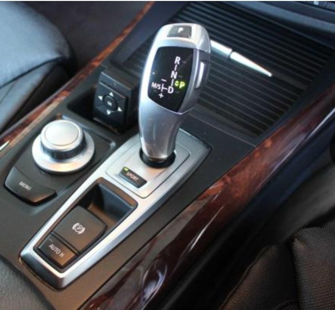

Apologies in advance for this question, but how the hell do you select 'options'? New to idrive so I have no clue, there's just the rotary controller and a menu button.

,Yours being a 2008 has the CCC , IDrive fitted, CIC was from 2010
Google CCC IDrive instruction ( YouTube maybe ) there's loads of info
CCC co trollers doesn't have the option buttons on the controller but you have to go through menus on the screen one by one, CIC is more direct
