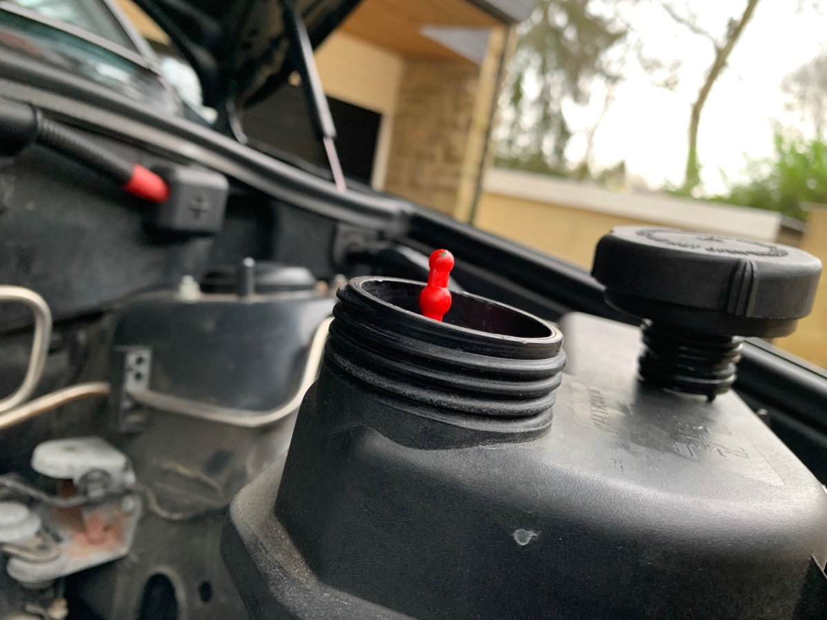

So the cap looks okay to me (not an expert), but there was a pressure release when I undid it so that I assume is a good thing.
Regarding the level, the garage topped it up last week but I didn’t seen how high it was, but it’s now this high (see attached).. does this looks “high” / “normal”?
Cheers
Mark

Re: Coolant drop
To me that’s ok, if I top mine up any more than that it dumps it back to that level, an indie once said to me "if you can see coolant in there and the low level light isn’t on then leave it alone. The military vehicles used to dump 4/5 ltrs out as soon as they were plonked in the desert. Rule of thumb was to let them find their own level.
- Alan Gunn
- Posts: 1506
Re: Coolant drop
As long as that pop's up ie floating you have enough in it.
