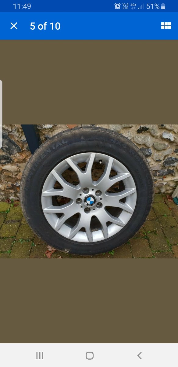

these are the wheels
the guy selling them said there off an e70 but everyone seems to use 19 inch.
they are really cheap.

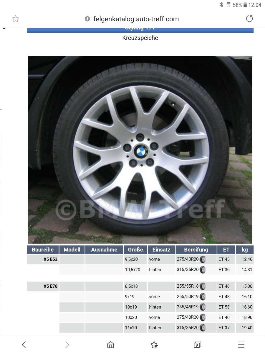

- Posts: 2170
Re: winter wheel/tyre question
There's an 18" version listed.

- Posts: 2170
Don't think 18" wheels fit over M calipers though. Get a part number from the seller and run it thru realoem against your vin #, just to be sure.

- Posts: 2170
Its always wise to check and be sure, but it appears this style of wheel for the E53 was only available in 20".
Best check is a part number into realoem and look on the door plate to check for 18" wheels being listed.
Personally i would prefer 19" but for the few months or even weeks they may be used, why not.
