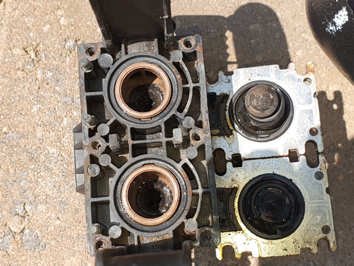

I've found some pictures of what I did when sorting this out. Apologies if the pics aren't in the right order! First is the insides of the heater valve. The rubber had completely perished, resulting in the valves not actuating properly and water not diverting to the right place! Symptoms would be that the heater sometimes would work, and if it did it was lukewarm, and it would never feel like outside cool air coming in. It's a pain to change, as it's located between the engine and wheel arch. Need small hands/long arms to do this!

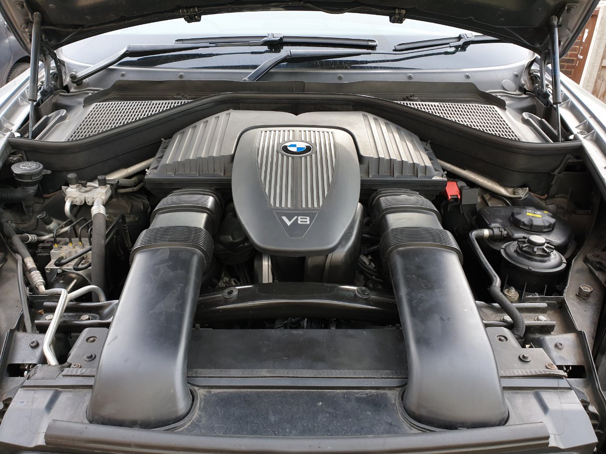

Other pics show the engine-to-firewall plastic baffle thing (not sure of the right term here!). You can see the before and after pics. The before pics show that there's a gap below the pollen filter inlet. Hot air from the engine bay was getting past this and into the inlet for the aircon. The after pic shows that the new baffle is complete which means that air for the aircon is coming from the windscreen area. Symptoms would be a lot more apparent in the hot weather, and especially so if the car has been sitting in traffic, with hot air coming in, despite temp set to 16 degrees. I'd need to turn the aircon on to compensate. This was after the heater valve repair was done. Now, I get ambient air temperature coming in if I need to.
Just for when you next take a look under the hood.
- new baffle

- old baffle, letting hot air in
- 20190512_154004.jpg (215.17 KiB) Viewed 4991 times
- inside old valve
- 20190420_121052.jpg (363.55 KiB) Viewed 4991 times
- new valve
- 20190420_110229.jpg (231.98 KiB) Viewed 4991 times
- old valve shows perished rubber
- 20190420_110221.jpg (214.11 KiB) Viewed 4991 times

Hi Rehan,
Had a look at my baffle, it was in 3 pieces and some bits missing, was in a right state. Is the baffle just the long thin Zig Zag rubber / plastic piece that goes along the top of the tray or the whole thing including the perforated covers etc ?Where did you get the replacement parts from and how much were they? Another symptom I have which I presume is related is every now and again the engine smell coming in through vents. Appreciate any feed back.

I got the bits off ebay, shipped from hong kong! Not sure of the exact listing, but I searched and found these which should be suitable, hopefully the link works. Quality of which seemed to be as good as original.
https://www.ebay.co.uk/itm/3PCS-Engine- ... SwRJZdST3t
Changing them isn't too bad, took me an hour or so. If the middle bit it broken, you might need to remove the metal brace thingy (you'll know what I mean). I didn't need to change the perforated parts on mine.
On mine, there was a rubber gasket that I needed to change, if you don't have yours anymore, you will need to get one. I think I ordered a new one. Item 21 is the part here: https://www.realoem.com/bmw/enUS/showpa ... Id=41_1747 - best bet is to search for this part number online and get it a little cheaper than what BMW sell a bit of rubber for.
Also had to use some draughtproofing tape along the bottom side as the replacement came with none attached.
Once it is done, it makes a massive difference, as you no longer have air that passes through the engine bay, and into the cabin. This could result in hot air, or other smelly engine smells lol. All air now coming in is fresh air.
