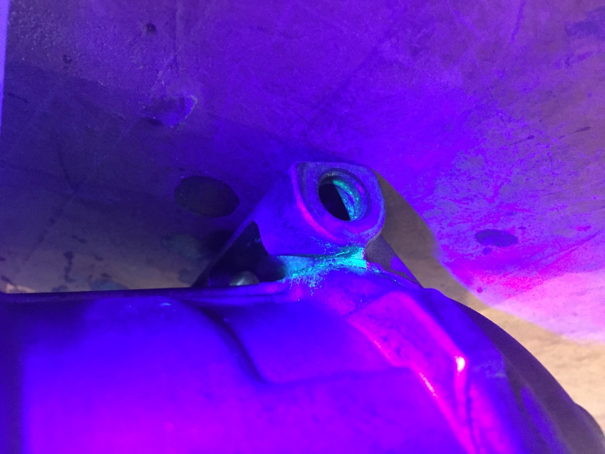

most likely a very slow leak, get a local ac specialist to put leak dye into the system, then under a un light would show the leak. I recently had this issue in last summer when ac would hold gas for few weeks and then start half side cold and then completely going no ac at all. dye detected a leak in condenser, after replacing sorted the issues, the placement of condenser take all the battering from lower part with salted water and debris so eventually getting rust and decay.
I wouldnt use the sealent of any kind.

This is the sort of small leak that shows up under uv
