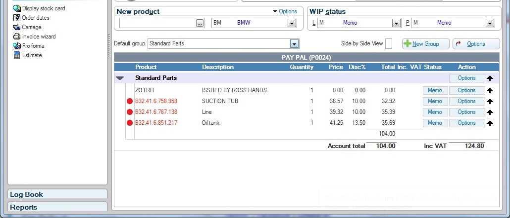

I’ve got a 4.6 so no doubt your pipes are different but mine were a lot cheaper for the 2 attached to the reservoir, I also replaced the reservoir whilst I was at it as it has a non replaceable filter in it and both suction and return lines which were £124 from Cotswold BMW - message them through the forum - they do a bit of a discount which my local BMW stealer won’t match (“don’t know how they do it blah blah”)
