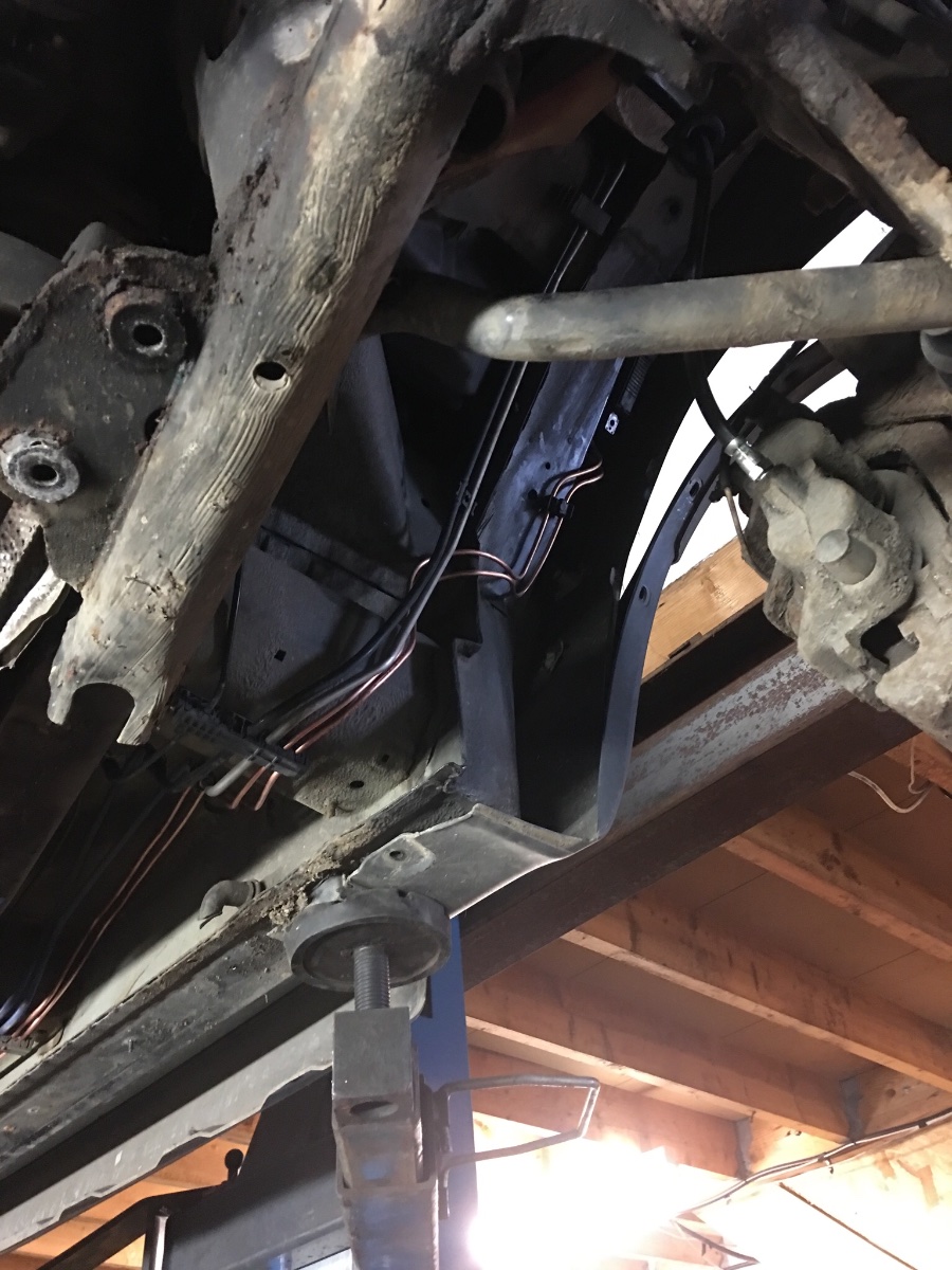

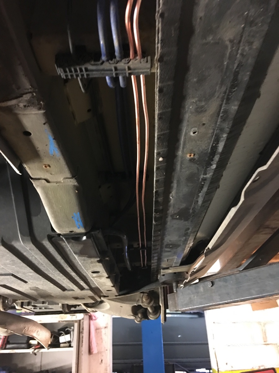

Yes all the lines run down the left side, which necessitates removing about 1 million screws (slight exaggeration) including the wheel trim. I had the rear subframe off for bead blasting and powder coating so for me the brake lines were easy and I used copper piping. With subframe fitted I would imagine it would be considerably more difficult

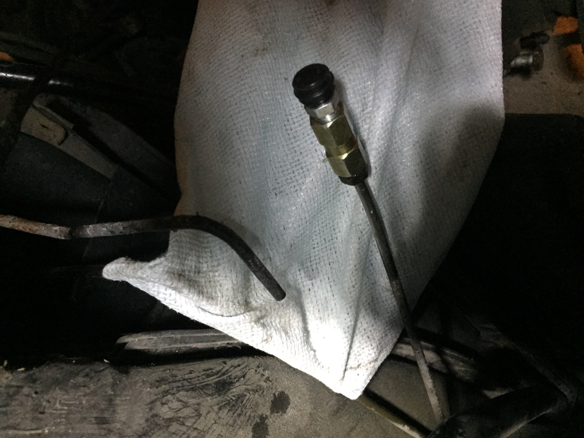

You can do it with INPA or some of the Foxwell tools ie the 510/520 and others. I didn’t use any of them, I used patience??
These pics show the intermediate pieces which join the lines together. Instead of a line one has a bleed nipple screwed in. I attached a bleed tube put it in a bottle, made sure the reservoir was full, opened bleed and left it. One line took 15 mins, the other took 2 hours for fluid to appear. done up the nipple and had a solid pedal. By that time I had finished fitting the lines to the callipers so I removed the bleed screws and joined the lines together, put the bleed tube on the Caliper and repeated.

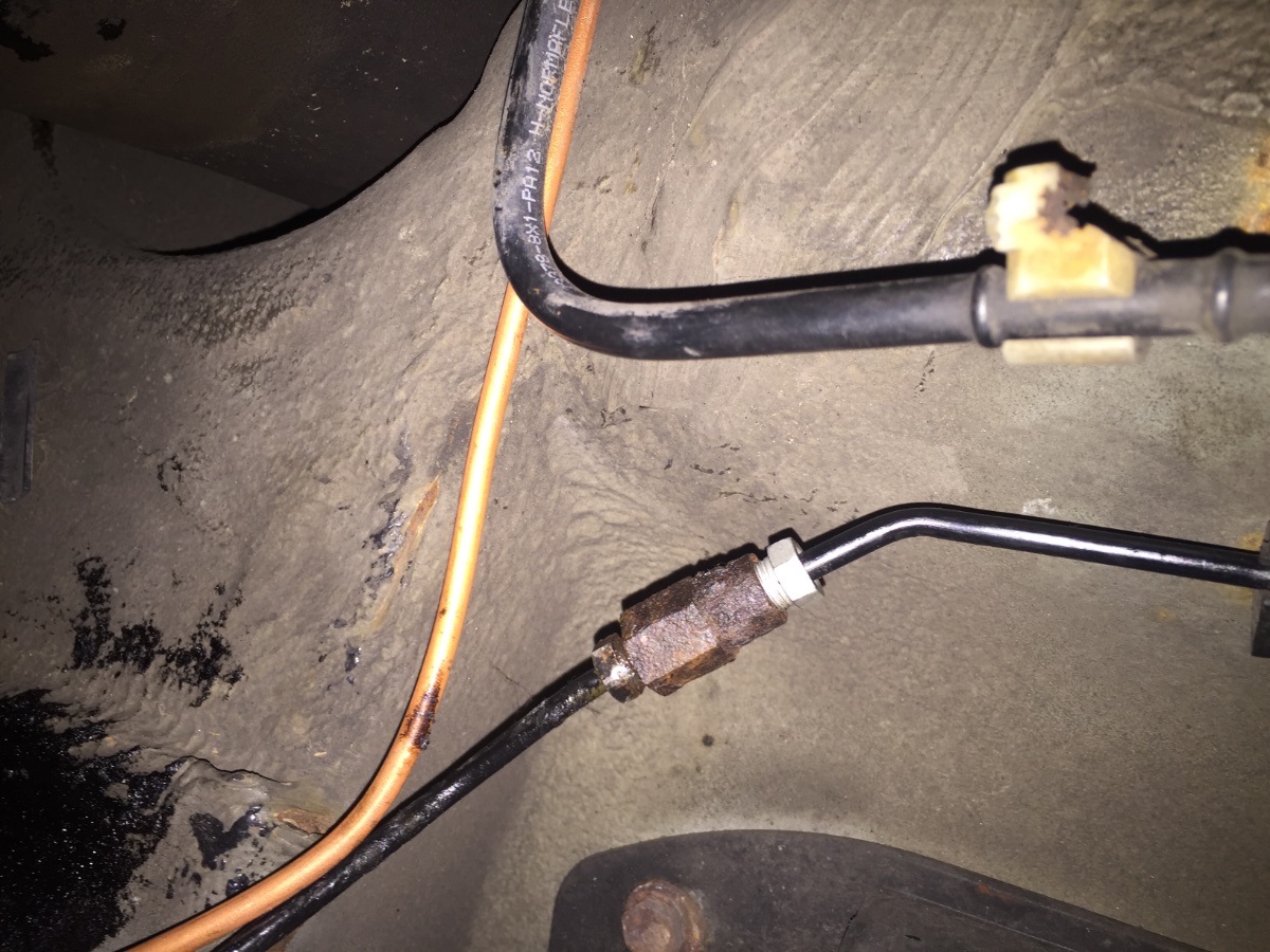

I also replaced all the fixed steel brake lines with copper due to bad corrosion, once you pull the plastic off you might find a horror show, front off side was weeping but not enough to drain the reservoir quickly - as soon as it was moved it split so I was lucky really.
The lines from the ABS run up into the front nearside wheel arch and behind the plastic all the way to the back so you need to drop that as Henry says - which you can do without too much trouble but I’d definitely order some new clips and rivets as there’s bound to be some that break. They tend to rust around the plastic clip that holds the lines to the floor which can’t be seen.

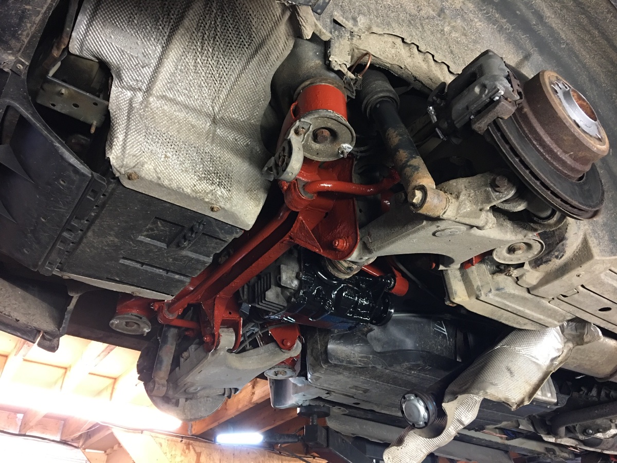

The lateral line that runs over the top of the sub frame is very difficult to see and replace - we dropped the subframe on mine - you can see where the fixed line disappears on my photo up over the rear bush - gave me the chance to refurb the rear diff seal and give it a lick of paint - every cloud!
