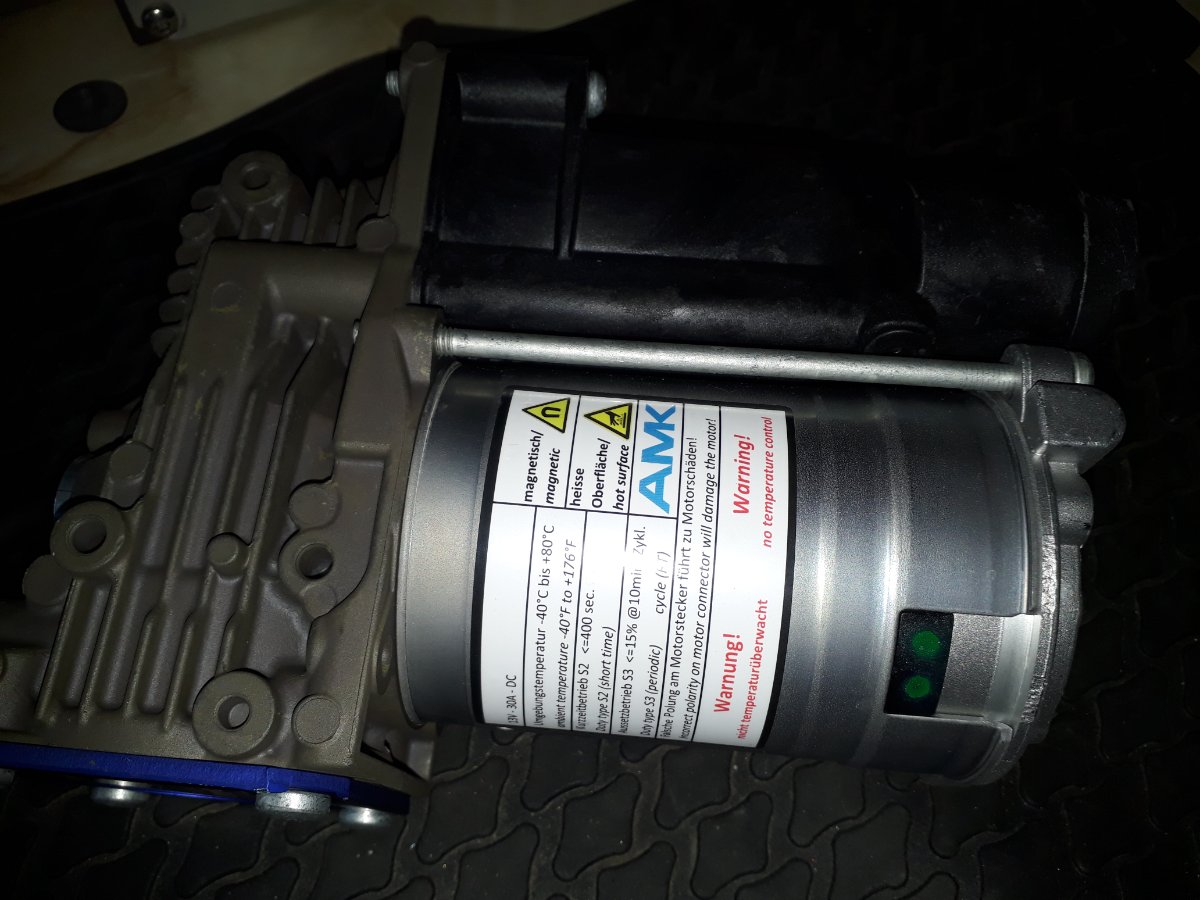

Well I received my pump this morn and when i went to fit it there are no threads to mount it to the bracket someone has forgotten to tap them and my studs seem to be m7 not the m8 I expected so even if the holes were tapped they wouldn't fit . The pump I removed was an aerosus aftermarket pump .
This pump in the pic is supposed to be a genuine AMk pump .
- 20190104_122935.jpg (194.67 KiB) Viewed 24702 times
Re: Self levelling system failure warning.
It has AMK cast into the end and the plastic so looks right ! Anybody else had an issue with these studs before ?

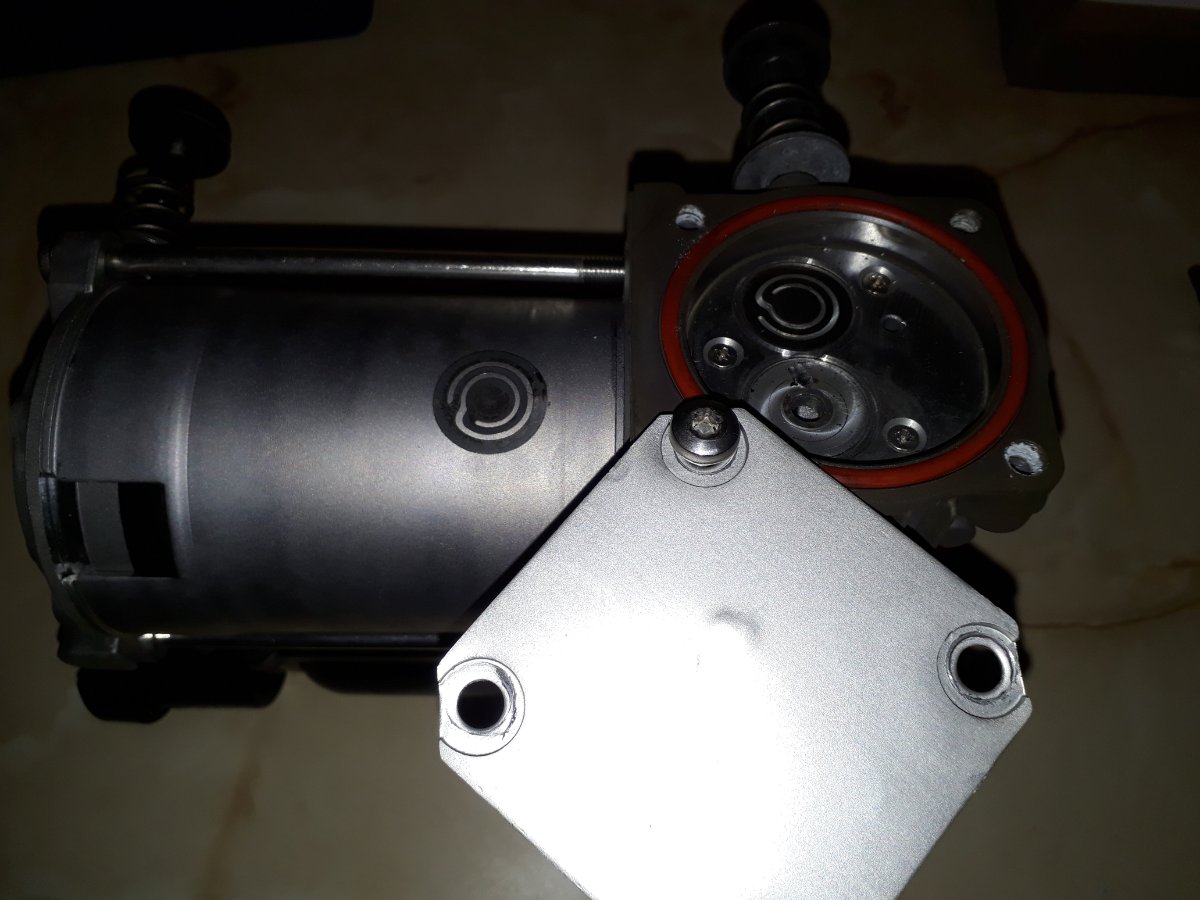

Took the cover of the old Aerosus pump and going by the dent in the lid something has been in there that shouldn't have been and has made a mess ! No date on it to say how old it is .

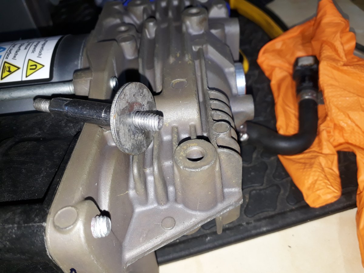

I've contacted the seller of the AMK pump and they say none of them come threaded when they are new , anybody else found that ? He is sending me some used mounts as the Aerosus ones are too small a diameter ,look like m7 not the m8 needed. If the old one had been an AMK pump I wouldn't have this issue , doesn't always pay to go oe lol

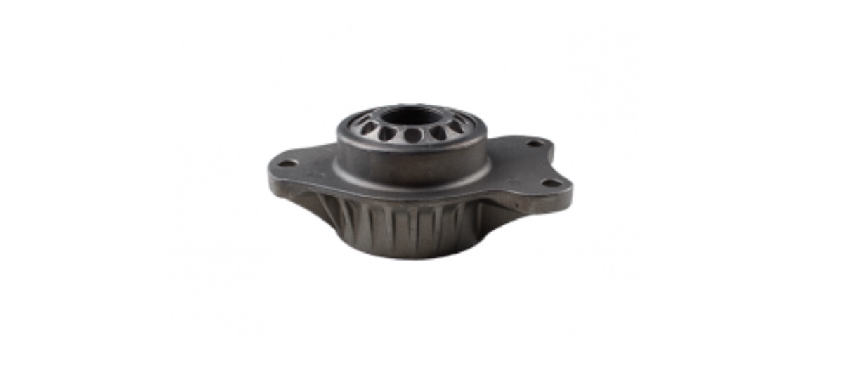

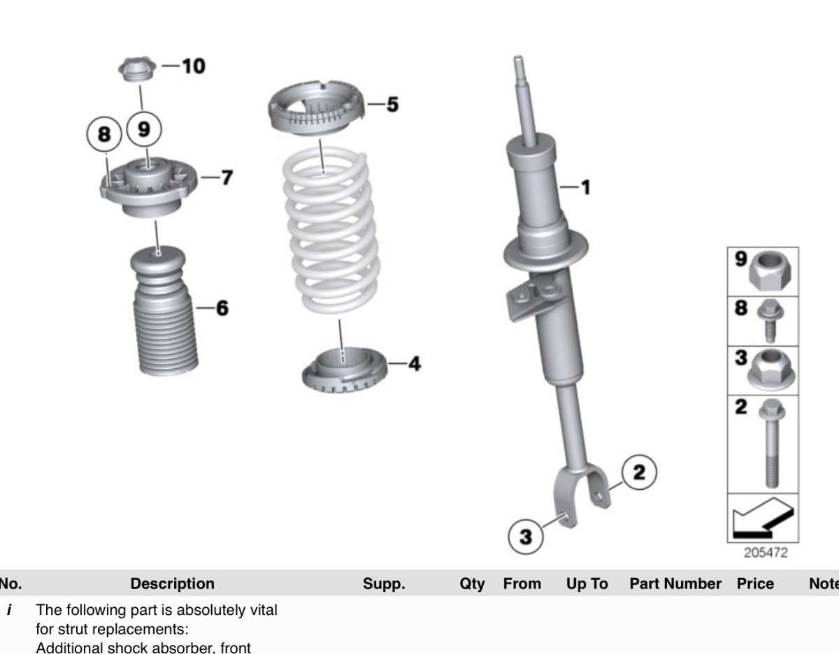

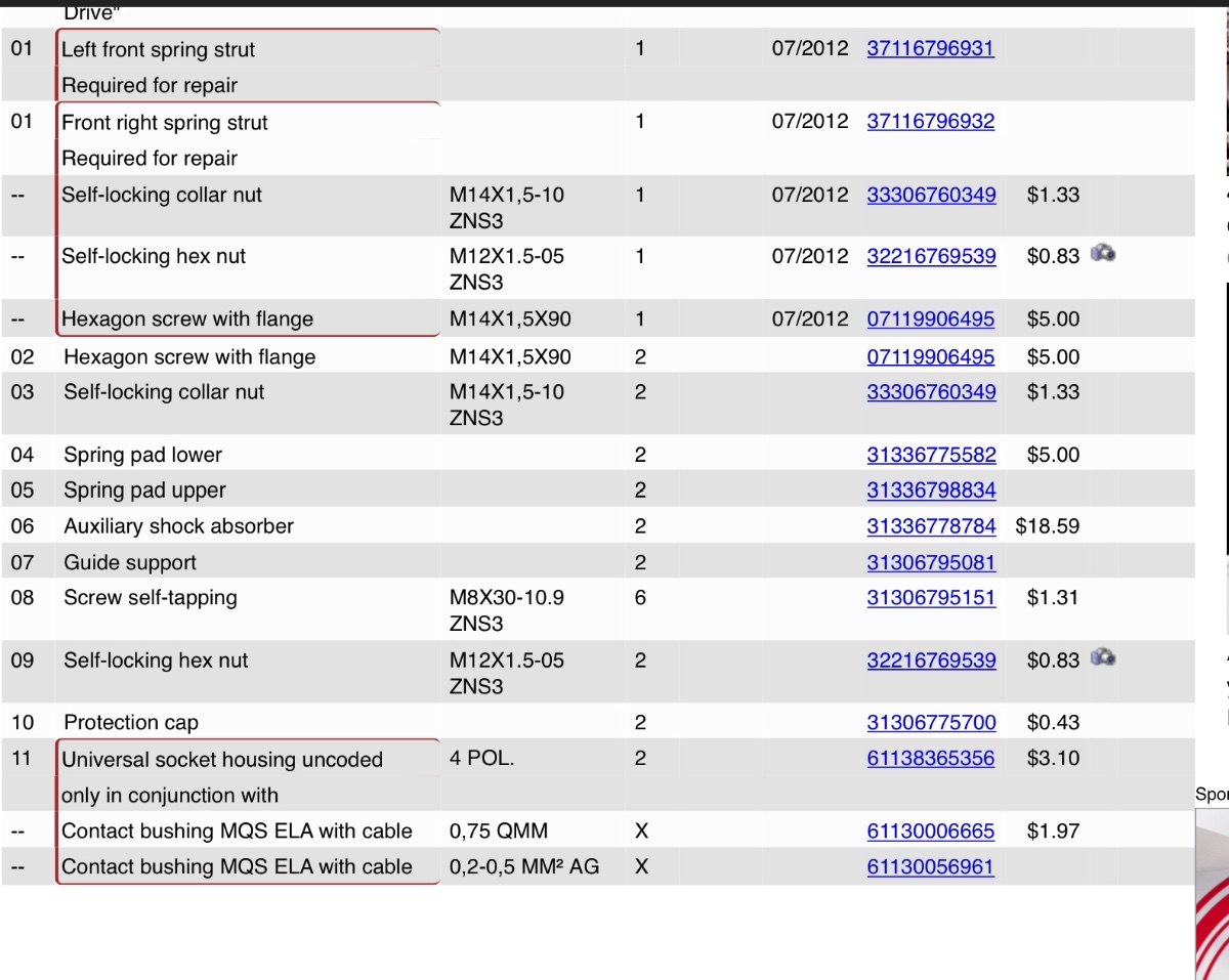

Not quite sure if I've got this right, but are you saying that you purchased a genuine part for a BMW that you had to tap out holes yourself, and with a stud!!!snrbrtsn wrote: Fri Jan 04, 2019 8:00 pm My response is not directed at AMK pumps, more generic
Over the years I have stumbled and frustrated over many new parts that don’t come threaded, the last being top mounts on my BMW 5 series GT
The said bolts that have parallel holes are for use once studs
The studs are thread cutting
It may be the same with the Compressor ??
Offer the stud and try and screw in
Unless holes are tapped out with a hardened tap then you will never get a decent thread, especially in a blind hole.
Incorrect
The top mount is as described and the mounting bolts are M8 self tapping
The metallurgy is different and the bolt (item 8 )is case hardened whilst the top mount is much softer
I went through all manner of complaint process when the second unit turned up
Myself and the Parts manager raised a Puma to ask and was informed of the self tapping nature of the bolts
The bolt is triangular, I’m guessing to allow swarf cutting up and out
I was bemused as your response initially!
I’m more than sure it’s not the sole used fastener on Bmws

I got the pump fitted this evening after nightshift , I did use a bolt to initially cut the threads and then the studs bolted up fine once they got started, I had an m8 tap but it wasn't m8 in the end. All seems to be working fine now and suspension level error is gone and rear is pumped up again.
Not much fun fitting this in the dark with a torch on the street though
No idea when they don't tap the holes at the factory maybe its to show a pump is new as you can't fit it without tapping them ?
I did run the pump with the 2 lines of the solenoid for 20 secs to blow out anything that may have been lucking there Incase it got back into the pump later as something clearing got squashed by the piston and put the nice dent in the top cover you can see in my other pic. I didn't find anything in there when i popened it so an worried where it is now !
