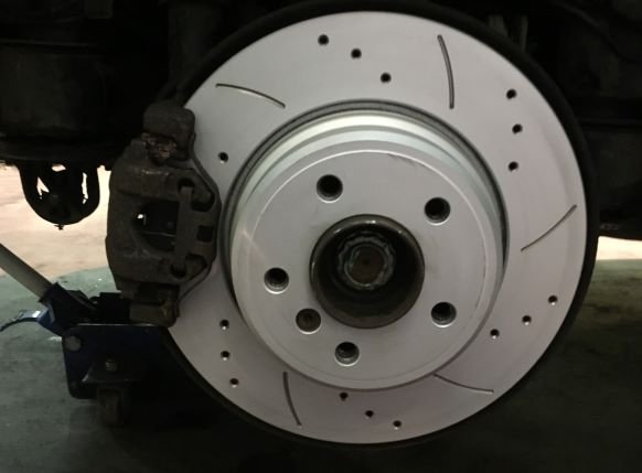

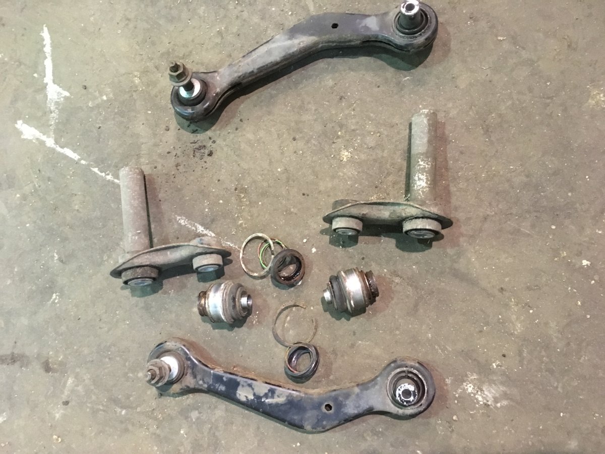

Since buying the x5 its had some serious rear camber going on more so on the drivers side today was the day to get it sorted i replaced this little lot
can i just say what was bmw thinking when they decided to have one of the bolts on the double bush arm threaded into the ally :headbang: you guessed it it pulled the threads out on the drivers side add that to the fact even with the special tool i struggled to get the new bushes in square getting them out was easy in the end i had to modify the tool to get them going in right , and it sure needed doing them lower bushes where well past it no wonder i had lots of camber , i topped that off with some new discs and pads to match the fronts
