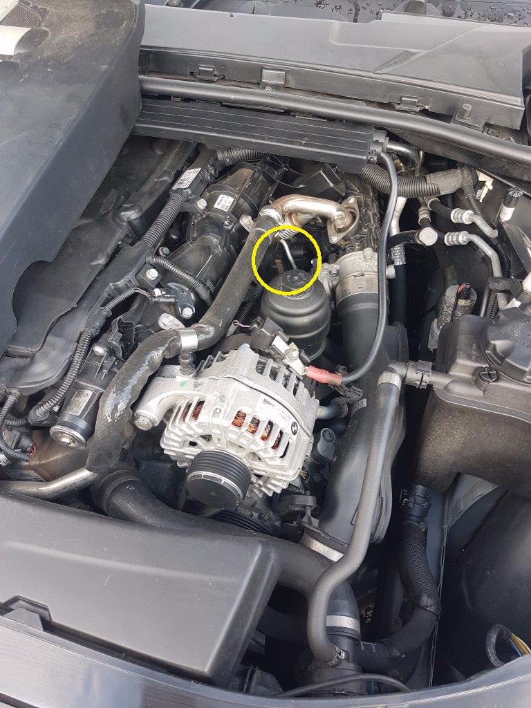

As it was sunny over the weekend I did the basic service on my X5 (oil + all filters) and was very happy to discover that the glow plug controller (which I need to change) is actually reachable without removing many parts (picture below was taken from another forum). Question I have is if you need to disconnect battery when replacing it? Anyone else did it on the N57 engine in their X5? Anything else I need to do in order to change it?

Yes disconnect battery, your lucky on my X6 35d you have to remove the intake manifold

Thank you. So that's a nice "little" job for Saturday

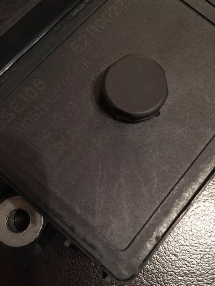

Pic below shows what I've received last Thursday - clearly not a new unit.

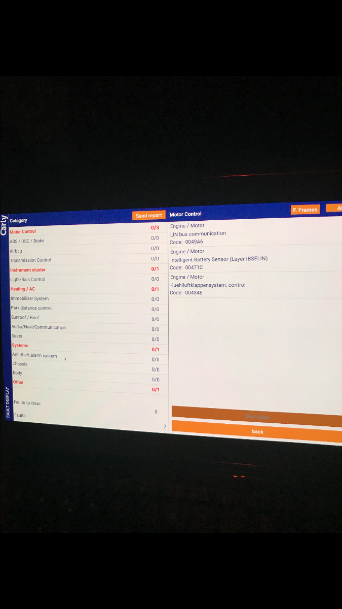

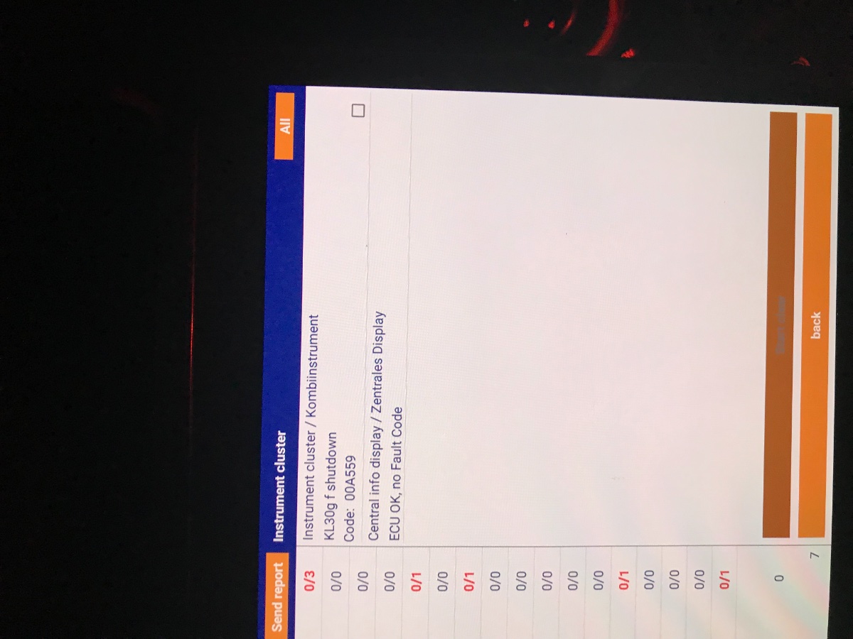

However me been very suspicious or cautious I did another read of faults. I have 5 faults but when I came out of dealership I now have 7.faults. ...2 more on the engine one for IBS sensor and another one attached below. So from a simple glow plug controller issue I now have the IBS sensor faulty???
If the warranty company denies claim I now have to prove dealership caused this.
