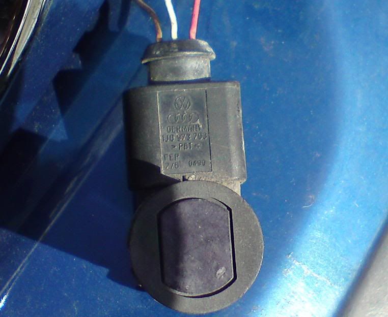

One of my sensors was completely smashed, so looking around for a replacement I noticed that they were quite expensive, but then I remembered I had some sensors from a ford galaxy, they use VW parts and comparing them with the ones on the X5 :o look almost identical, the connecting plug is different but both these sensors have numbers for the three wires on the plugs 1 2 3 so I spliced in the wires 1to1 2to2 etc and hey presto it works :o :D :) :driving:

The sensor exactly fits into the holder of the X5, the VW sensor I used was the L shape, I had a little difficulty fitting it to the front dumper, as they normally are a straight sensors in the front,
I have a strong feeling that these sensors are from the same manufacturer ;) the only difference is the plug and the angle, straight or L-shaped.

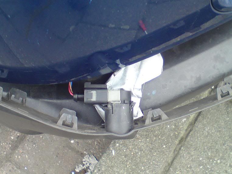

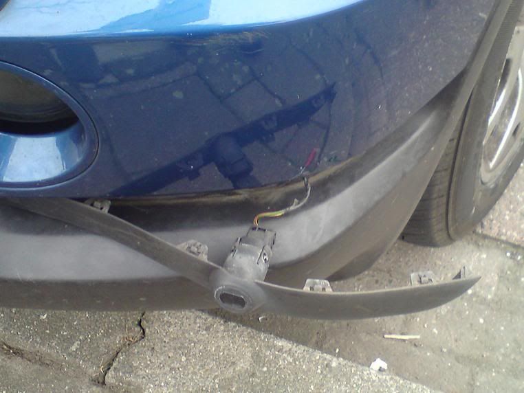

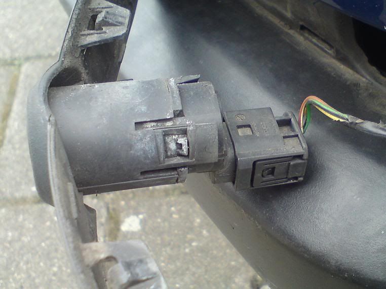

Okay let's try and clear things up with some pictures of the senses on my X,
the first picture shows the passenger side corner this is an original straight sensor
The second picture (passenger side) is a close-up showing the original straight sensor in its holder,I believe the most sensors from other cars will fit in as the circular diameter is the same though the slots that guide the sensor may need adjustment (I used a Stanley knife)
The third picture is showing the sensor on the drivers side that I fitted from the Ford Galaxy which is L-shaped, it was a little short compared to the straight one(original) that I had already moved to the centre to replace the smashed one in the mangled bumper

Is that foed galaxy one in the third pic actually cliped in ? i ask as it looks like it may come loose going over bumps etc.
Please don't think i am knocking your efforts just want to make it clear for others that modification is needed before they go out and order ford parts that may not fit :thumbsup:
As said before if it works for you then kudos and thanks for sharing :thumbsup:

[quote=""x555""]So my asumption above was right then they dont fit without cutting away the original holder.......but hey ho if it works for you well done :thumbsup:
As said before if it works for you then kudos and thanks for sharing :thumbsup:[/quote]
They fit into the holder ok, but the clips that lock the sensor in place need to be adjusted (cut with a knife)
They seem to be reasonably held by friction alone but to make sure I added some Gaffer tape :thumbsup:
Please make sure you use Gaffer tape and not some other types of sticky tape as this may affect your warranty
I find that Gaffer tape can last many years and yes all my senses are still working fine :thumbsup: :thumbsup: :thumbsup: :thumbsup:
