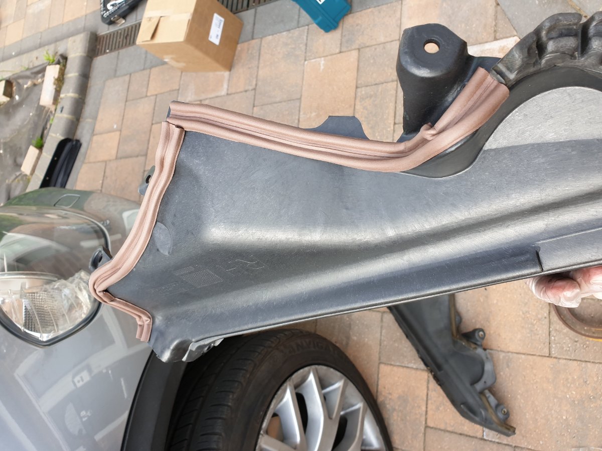

Thanks for very quick reply, the link worked fine, may be daft question but which profile would you say is best?
rehan
- Posts: 34
- Joined: Thu Apr 11, 2019 9:55 pm
Re: Hot air from vents
No problem! I think out of the lot, P should be good. This is what one side of mine looked like:
