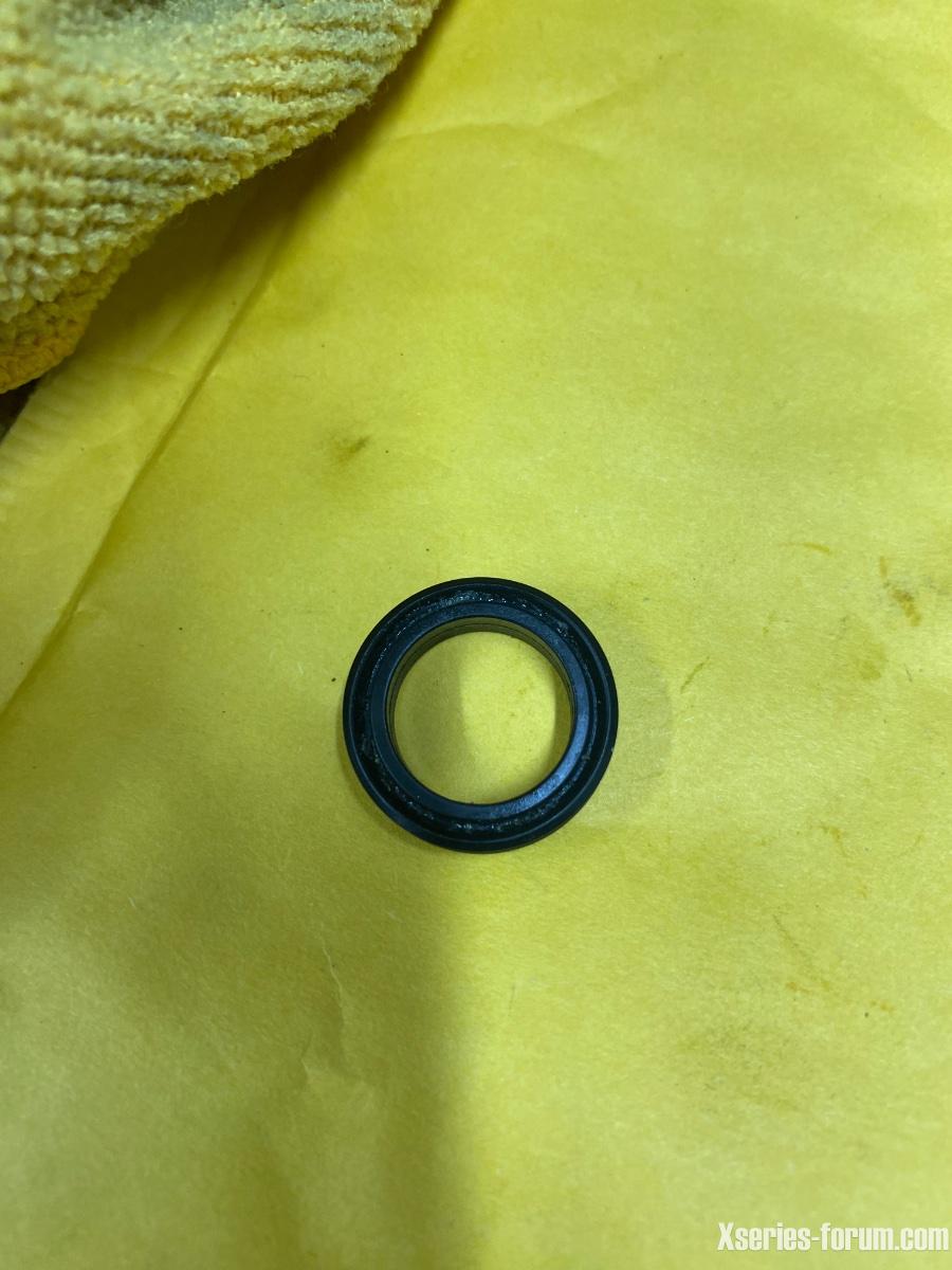

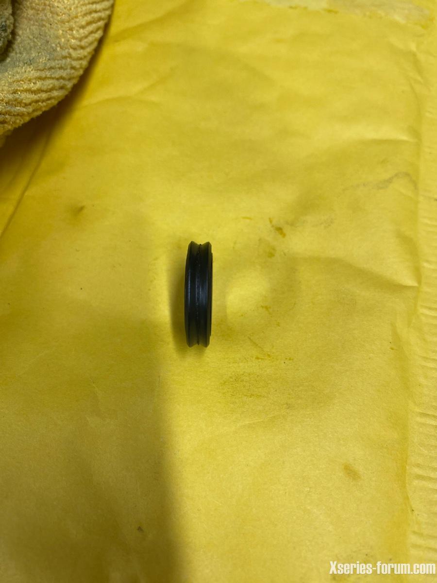

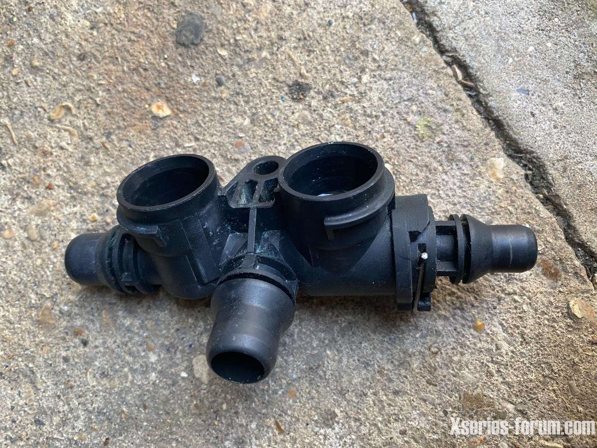

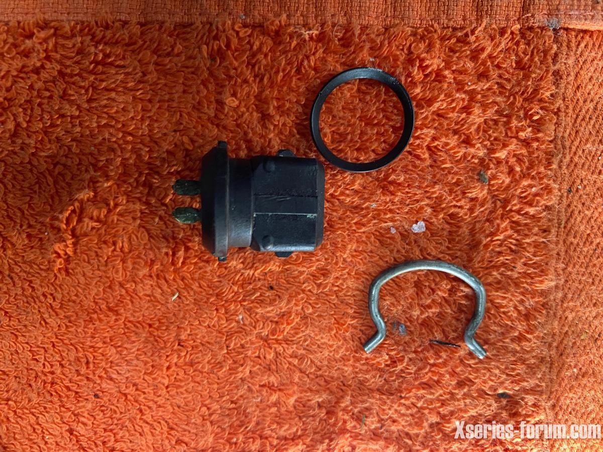

I’ve finally done the "o" rings. They don’t include the 2 rings that mount the g/b thermostat nor the seal (cone shaped) for the thermostat heater housing. Can’t find that seal anywhere for sale neither can the Americans the other 2 aer available from BMW but expensive. Of course I chucked the the heater element one away.DOH.
I’ve used a seal from my a/c seal box for the heater element and it seems to work fine, at least for the last 50 miles.

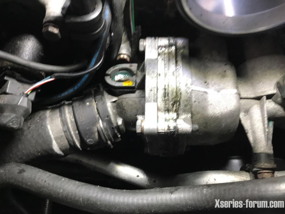

Well,been on a long run and all the viton seals are doing a wonderful job. However the system has found the next weak spot, the coolant pump housing seal/gasket, very minor but nonetheless irritating. So I’m going to get the 80c stat and do both while I’m there. Hopefully this will put the coolant problems to bed.
