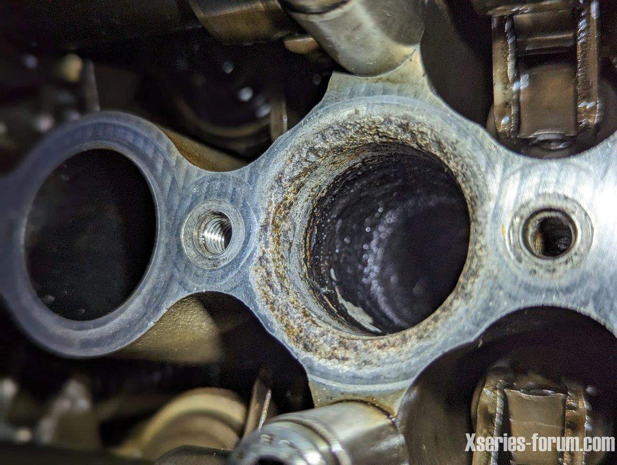

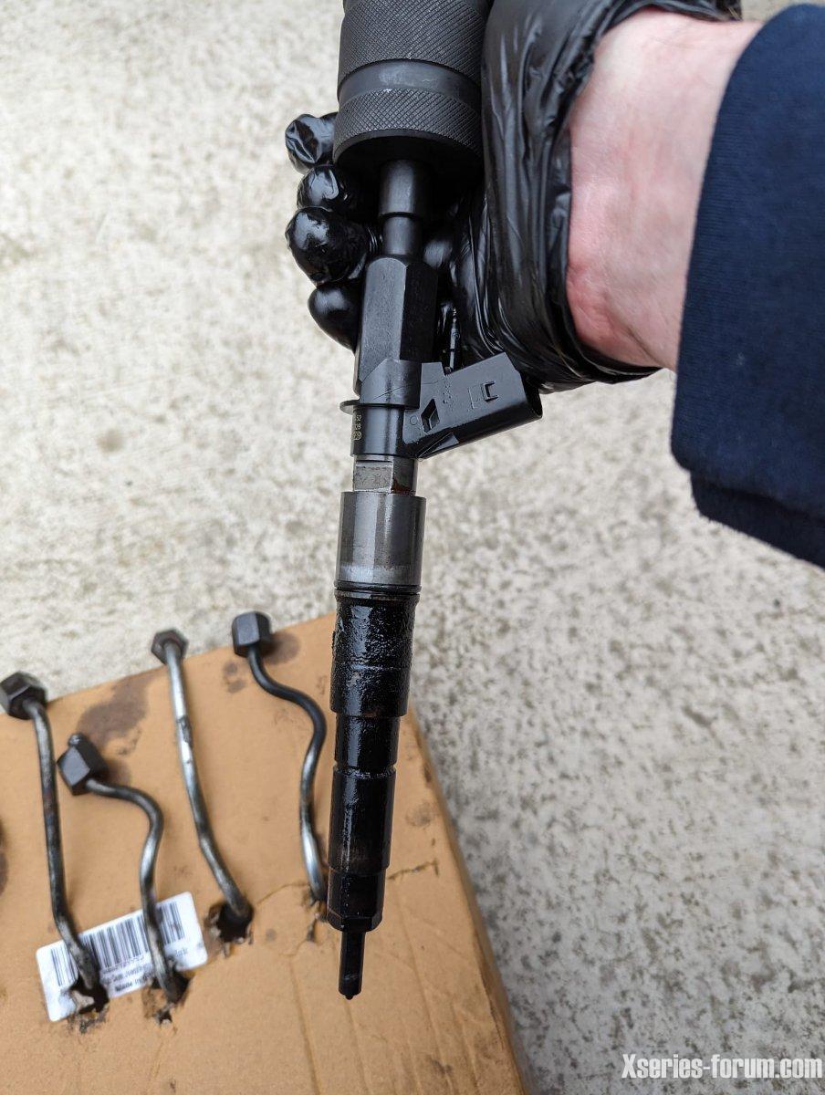

Post by Sm[]key » Sat Jul 06, 2024 10:24 am
It was caused by corrosion on the top of the cylinder head, rain water had been dripping down the injector bore and sitting on the head. The Cylinder Head cover gasket had perished and no longer flexible, this helped the corrosion mechanism to be set up.
I sorted it a few months ago, it involved all injectors out and then using high temperature epoxy liquid metal to build the material back up and flat down with a block on the head and a reamer down the bore. Replaced the cylinder head gasket and all injectors back in with new copper seals.
No problems experienced so far and probably done over 10K miles since the repair.

Injector didn't look too healthy below the cylinder head...
Posts: 1553
2010 E70 X5 3.0d - 'Chuffin' Injector
Post by Leslie » Sat Jul 06, 2024 10:35 am
The drip covers at the back corners of the engine bay tend to split and that lets rain water pool on top of the 2 rear injectors which causes the electronics to fail in them over time. My drivers side one was that way so I replaced it , they are expensive for a bit of fibreglass ,over 100 quid so id repair next time and with all that oily diesel as it gets burnt and turned to carbon you can see why some injectors are very difficult to get out . You will see 300k yet with this one :driving:
