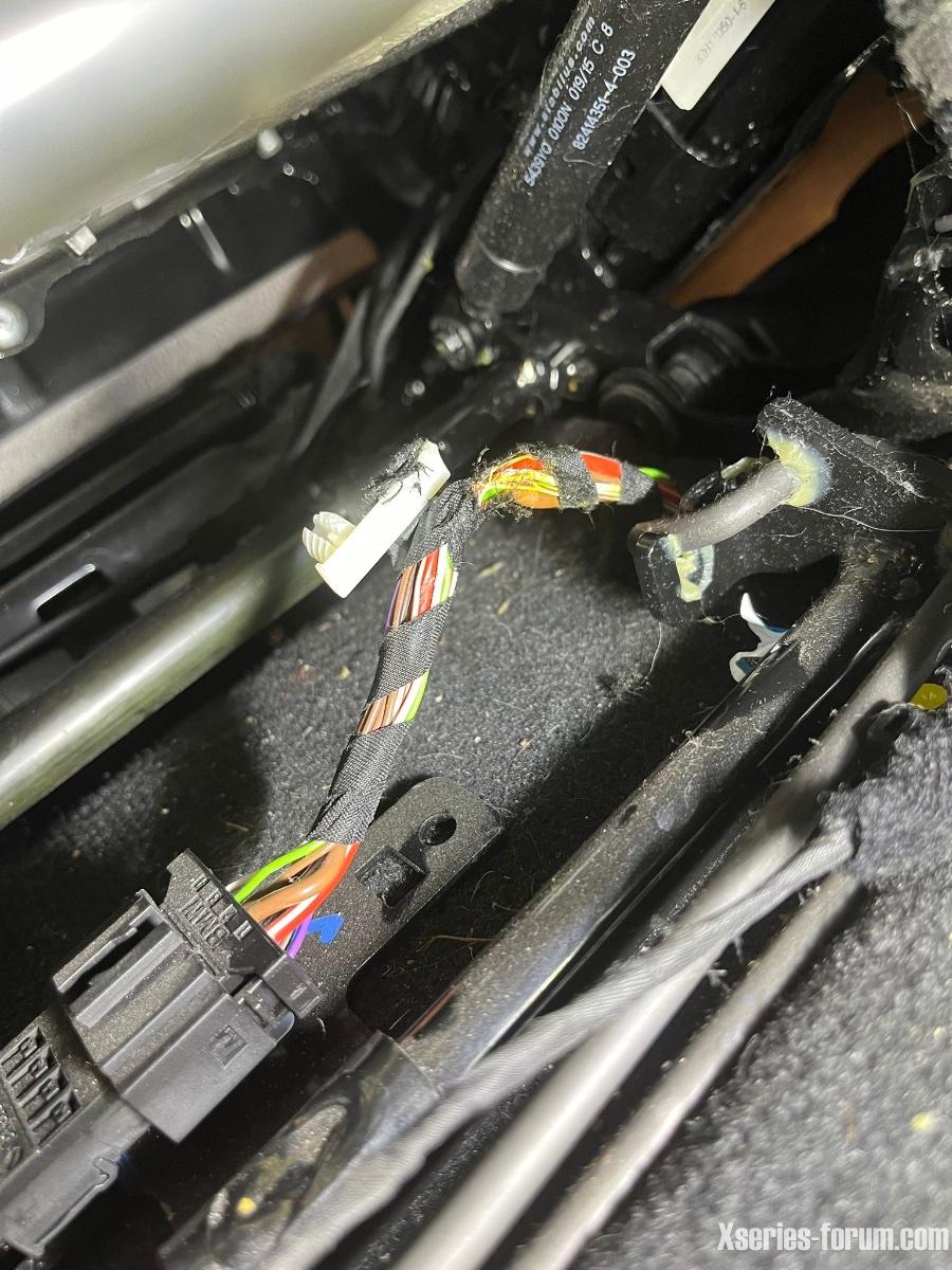

Hi folks. While investigating a non functioning heated rear seat, I noticed part of a loom under the rear seat had worn through. I’m hoping from seat movements and not mice!
Before I fix it, I’m trying to work out where the white clip should be positioned. You’d think it would clip into the hole shown below it, but it doesn’t reach naturally.
Assuming the loom is still present in cars without heated rear seats, are there any owners that would mind taking a photo of their car to let me see where the clip should be?
It’s the passenger side on a RHD car.
