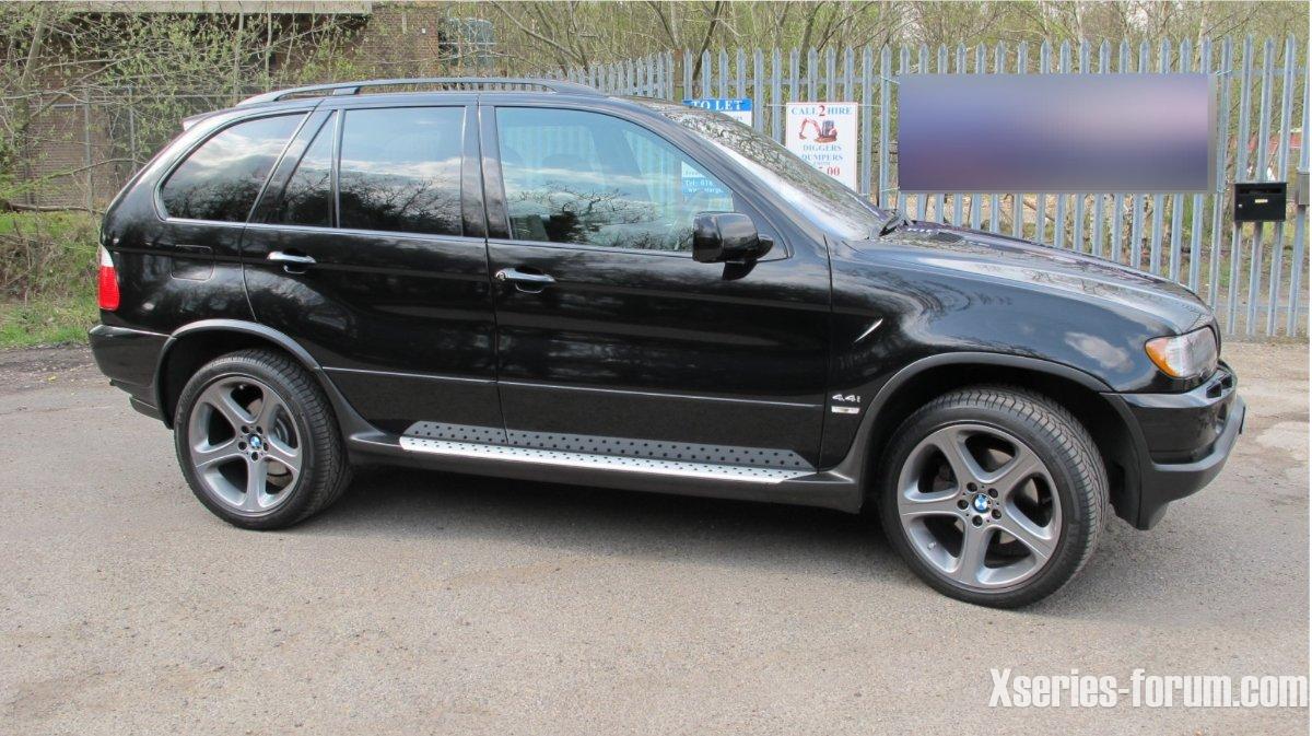

My E53 was an early 2001 example so had analogue TV, which i didn't upgrade, i sold the car. I still miss the V8, a 4.4 in my case. I think i recall upgrading to the BM54 radio receiver, cant recall why now, and adding bluetooth for the phone system, a kit from the US of A. I tinkered with quite a lot of stuff on it, a set of 4.6is wheels made a significant visual change. I sold it to a one time member here. I even tried to buy it back some years later.
