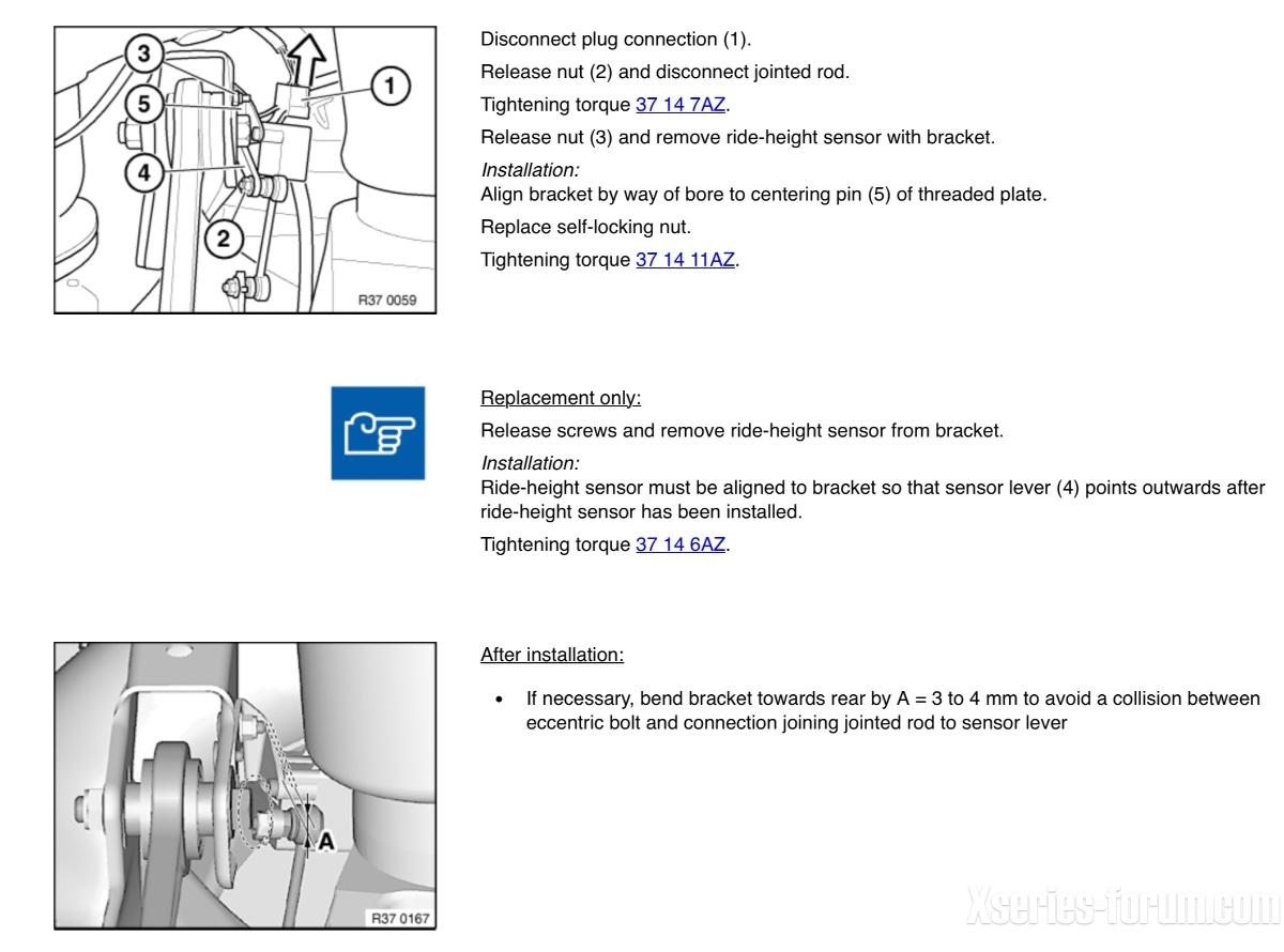

Is the ride height sensor OK?
You can see it looking at the underneath of the car from the back. It's located on the lower suspension arm- a little black cube, (size around 50mm each side). It will have a plug and a little arm, with a tiny ball and socket each end.
