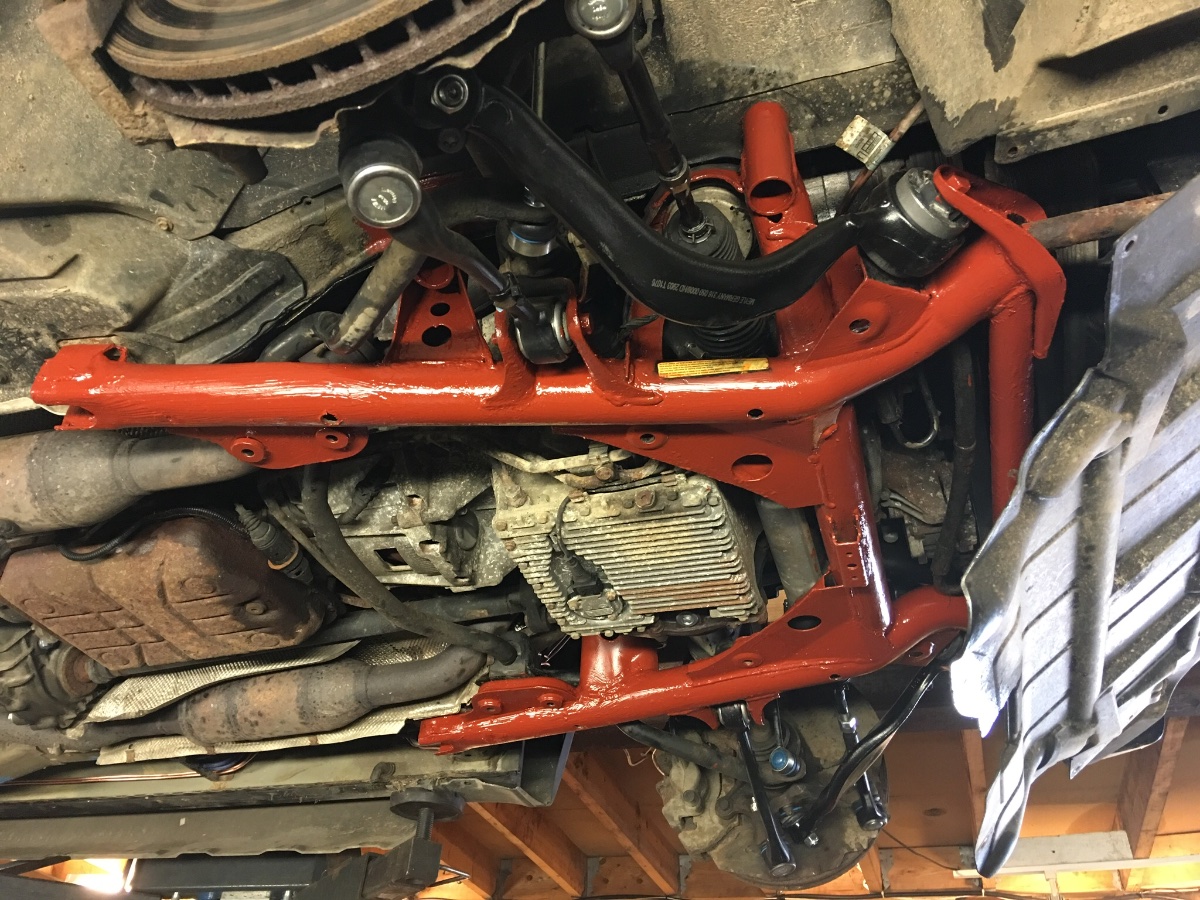

Did my front bits and bobs with one of the Meyle HD kits from B&B components in Maidstone http://bandbcomponents.co.uk/page/meyle_hd.html.
Went with Meyle HD as it’s supposed to have a 4 year warranty, what the odds of that being any use are I don’t know!

nice job that - those are all the bits im looking at doing - wish i had a 4 post lift :thumbsup:

Sleepyfolk, your just making the rest of us feel bad. I see your g/b sump is as rusty as mine. We should have induced an oil leak years ago. Nothing like an oil leak for keeping things rust free :)

Might stick some paint on it when the ramp is working again at work, we’re just redoing the floor in our unit and then I’ll have a 2 post ramp to play with all the time! Think I’ve used up my favours at my mates garage, apparently they have paying customers they need to service, bloody miseries 😝
