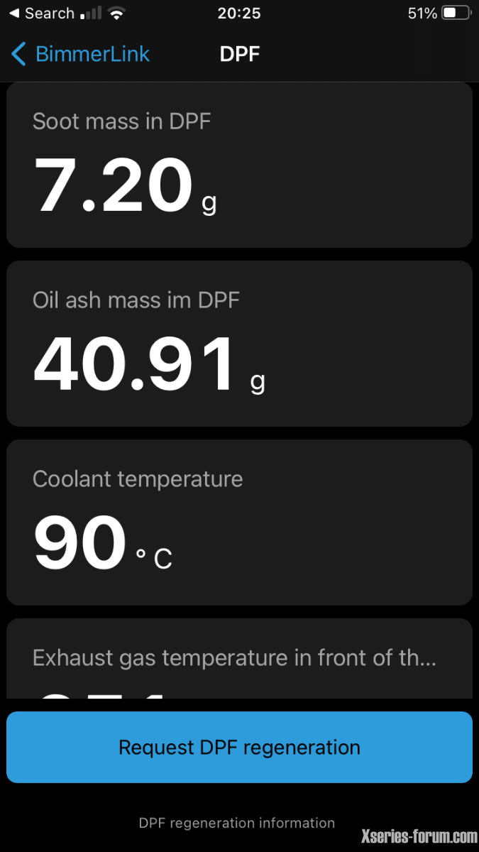

@X5Sport, thank you for your insight in the issues with my X5 and apologies for the delayed response.
Firstly, the good news is that my parking and ABS lights issue was apparently caused by cable loom damage behind the gearbox under the car. This was found by them after a couple of hours of electrical tracing. May have been damaged during a past repair and since deteriorated over time. The Indie garage replaced the damaged section of the cabling and the issue is no more.
Have asked the Indie for a price on the replacing the glow-plugs and controller and will look to getting that done with the service . Do you think the EGR/DPF will need to be cleaned in the process? I attached a snapshot of the DPF values from Bimmerlink - not so meaningful to me.
Also, due to less commuting nowadays, have noticed the rear driver side of the car dropping when parked for a few days. I guess this points to a slow air bag leak although I would have expected some error codes related to this. I will need to address that too at at the same time!

Those DPF figures look OK. If you aren’t using it much then we’ll worth a run on fast roads, get the car fully up to temp and then if there’s a dual carriageway locally, keep the speed above 40mph - faster if poss - for about 20 mins as that is what is needed to get a DPF regen cycle to run. You’ll know if it’s happening because the engine fans will run at full belt for a while to keep everything cool away from the exhaust. They should happen every 300 miles or so, more often if short journeys. Your tool may tell you how long since the last one happened.
I didn’t bother with the EGR and my Indy (a BMW Specialist made no mention of needing it.
