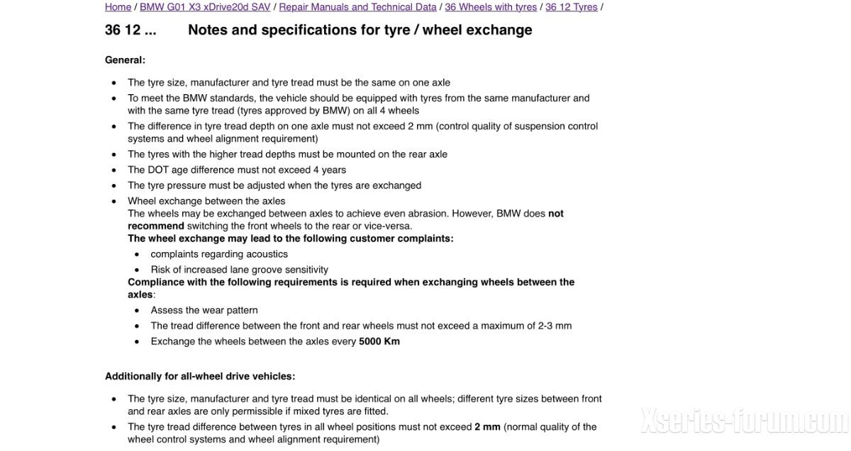

Post by X5Sport » Thu Jul 21, 2022 6:10 pm
This is straight from the official manual …… note last paragraphs as well. 2mm difference anywhere.

Post by lynx2022 » Fri Jul 22, 2022 7:21 pm
Interesting……thank you; is this available to download from BMW? I saw the technical manual online, but it required a login to access the information. 2 mm is not much difference, & would indicate that I would need to replace 4 tyres, due to a nail in one of them :headbang:
