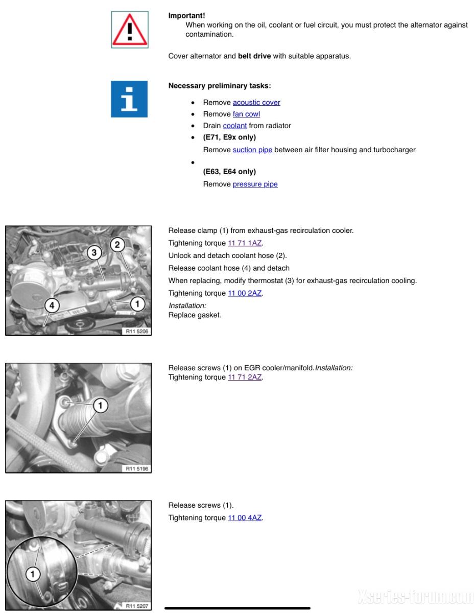

thanks for that, I'll have a look on Real OEM. I recall my 3 series had an EGR thermostat (the short black plastic one), but not it's own rad. Do you know where it is?

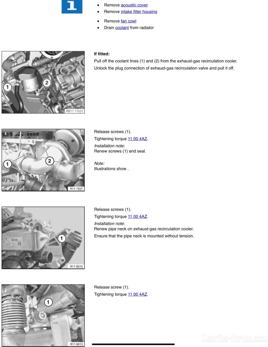

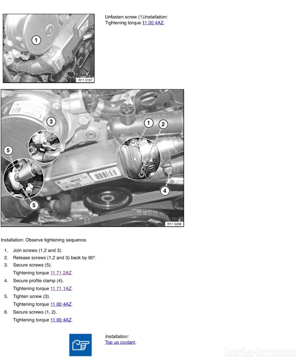

They don’t all have one. Hard to tell from the images I found, I think it’s top front of the engine for the 30d (almost the same as the E46) and right side on the 40d about halfway back.
30d …N57
30d …N57
- Posts: 19090
Possible head gasket failure
Earlier 30d (M57 engine)

Have just been looking at Real OEM and am now wondering if it's the EGR cooler or thermostat. Is there a way if this is faulty or not assembled right water can be either pulled into the inlet manifold or it can become pressurised and water pushed into the exhaust? Been a while since i took an EGR thermostat apart (and the car's 300 miles from me) but i recall they're fairly simple inside.
