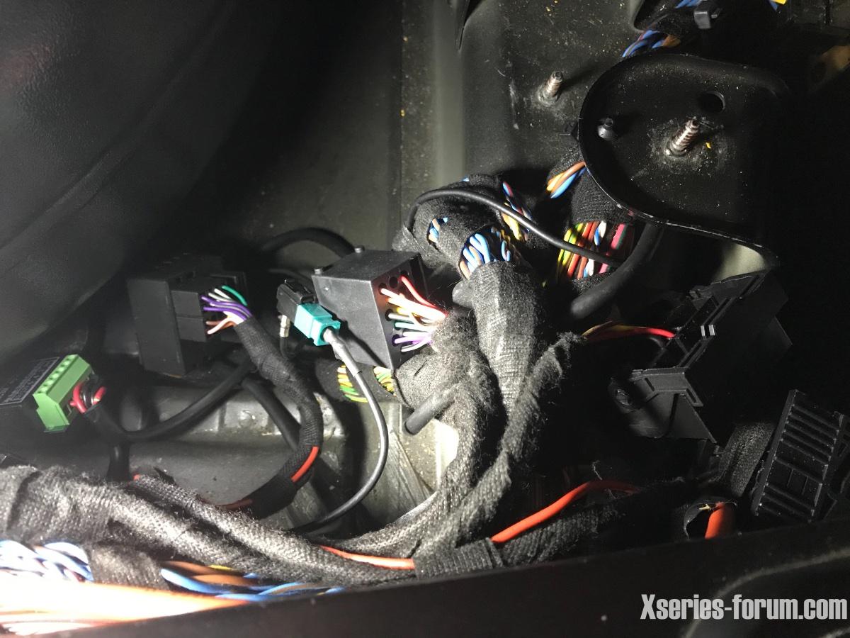

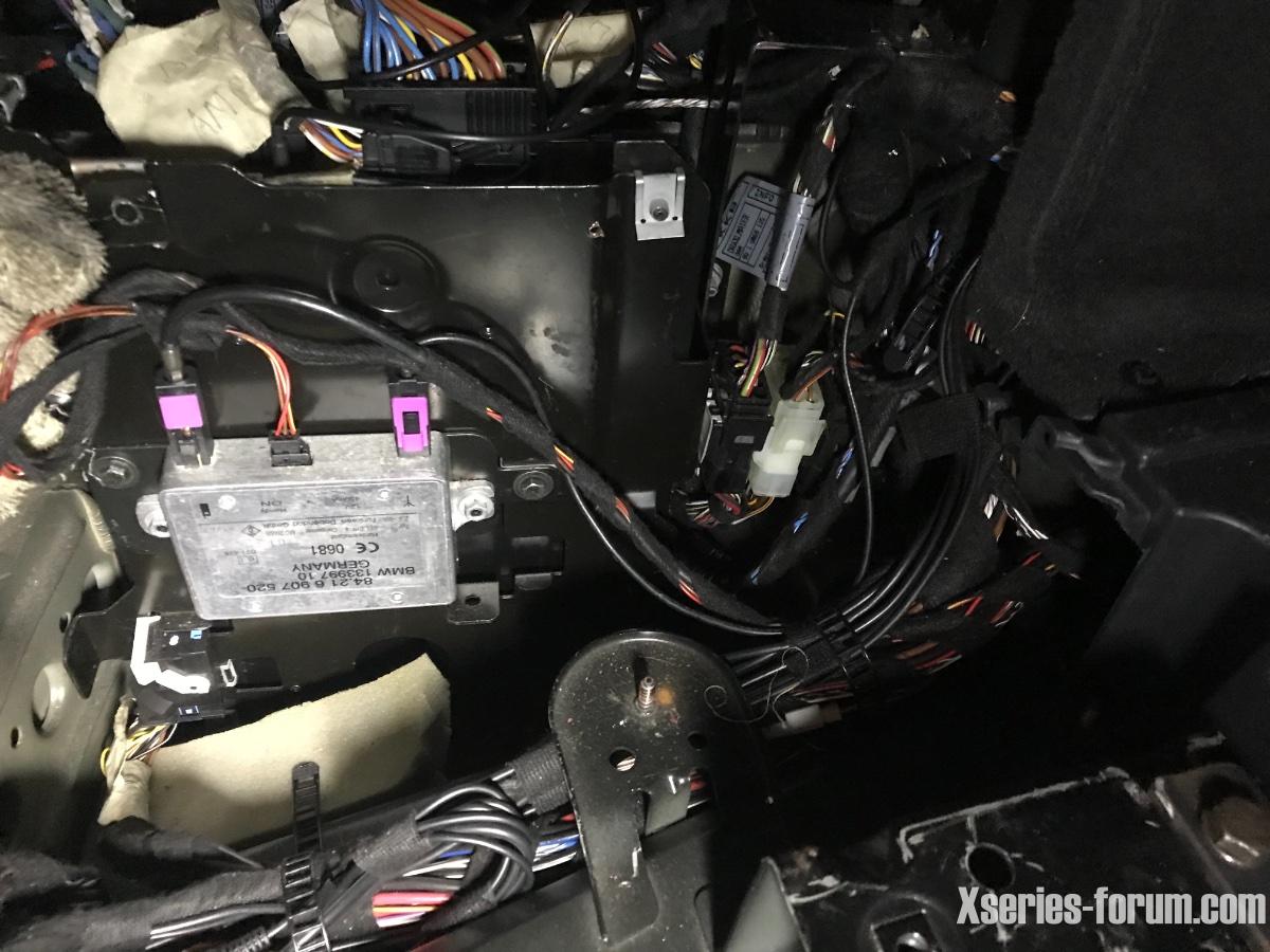

Ok took a few pics
Even unplugged the cable in the boot and no change of sound. On the box where are those 2 leads coming from or going to.

I believe the first picture is Telephone GSM booster (mauve connectors) did your car originally have a phone in the armrest. The second picture the Blue Fakrs connector is the radio antenna
You will need a Fakra to ISO converter (if that is what your new radio accepts) then an ISO Ariel lead then your signal should come from the Antenna in the spoiler.
