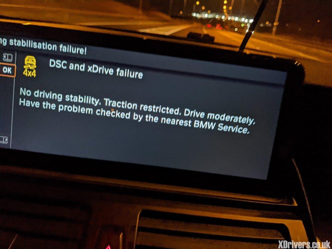

Hi
Recently got this motor and also recently drove it on the motorway, from about 55+ mph the car starts to rumble / judder.
Today a fault came up which resets when the ignition is turned off.
The 4X4 light comes on in the centre of the dash, and a stability error is shown on the i-drive display.
Any one had this problems before?
Would like to know what it is before I go to the stealers.

- Posts: 19053
Re: 2010 E70 X5 3.0d - Judder / Rumble on Motorway
Certainly needs looking at. Any jerkiness at walking speed when in full lock?
One check you do need to do though. What tyres are fitted, are they all the same size or different front/rear, are the pressures right, and what is the tyre wear like on all of them?
A common cause of what you describe is the wrong type of tyre fitted (more of a problem for staggered sizes) or more tread wear on any one axle (or wheel) than any other. There should be less than 1.5mm difference between any one tyre and any other.
xDrive cars are very sensitive to tyre choice and a bad choice can and has destroyed diffs or transfer boxes. It may not be you issue but it needs checking. The correct tyres should ideally be RFT and have either a ‘*’ mark or ‘MOE’ mark on the sidewall. The ‘*’ means approved for BMW with ‘MOE’ meaning Mercedes Original - Extended and also OK for BMW.
If nothing else it seems like you need the transfer case fluid changing - it should be done at 8 years or 60,000 miles from memory. Sealed for Life is just BMW speak for three years whilst under warranty!
Thanks for your advice!
I think you may be right about the tyres had a look last night, the tyres are bigger on back 315/35/R20 & 275/40/R20 on front..
The rear tyres don't look good! Going to get them changed today and also get a check done to ensure the wheels are not deformed on all 4.
I did a test by getting back up to speed with then X5 and then engaging the auto box into neutral, the judder still remained.
Hopefully this is pointing towards a tyre / wheel issue?
Well having spoken to a reputable tyre dealer today and hearing the tales of woe with X5's and various intermediate grade tyres I went for the BMW approved Bridgestone Dueler H/P Sport Run flats all round.
My bank balance took its greatest ever tyre cost hit, but immediately the rumble / judder at speed disappeared!
I have never known a car be so sensitive to tyre choice! Turns out I had a different tyre on each corner and one of the rears was down to 1.6mm, all the others healthy tread.
Hoping the gearboxes haven't suffered from the previous owners tyre choices!?
Going to change the transfer box oil tomorrow hopefully, oil is on order from BMW.
I tried full steering lock test in both directions but nothing to report back with!
The test will be when I'm next on a motorway and if the 4x4 fault light comes on again?
Thanks for the advice everyone!

- Posts: 19053
Welcome to the world of xDrive, and why BMW actually means Breaks My Wallet.
Once the transfer box oil is changed that will at least clear the warnings. If all is quiet then at least you know that’s a job done.
BMW aren’t alone with this fragility and I believe it is only the very latest versions, with staggered setups, of the X cars where the issue has finally been more or less resolved.
I was on the motorway a couple of times last week and the fault came up again? Switching off the ignition cleared it.
So it looks like changing the transfer case oil and checking the transfer gears did not resolve the 4X4 warning light problem.
Where do I go next?

- Posts: 19053
Error 4222 & 4262 are related to the glow plugs. You might have both failed plugs and a failed controller, or just a plug or two. Not unusual for a faulty plug to take out the controller. This is a diy job as long as you take great care and use a release agent for the plugs because they can and will seize in the head resulting in them snapping. It isn’t an engine apart job if they do though as there are tools that will recover the debris.
BMW recommend use of Brunox lubricating grease Part no: 83 23 0 418 567 (RealOEM lists it as Herstellerlabel, EU Multifunction Spray.
55C3 is the ‘limp mode’ warning. May be triggered by a dodgy ABS wheel sensor.
5EC0 points at a steering angle sensor issue and may trigger limp mode code above.
C519 and E1E9 and both in the infotainment system and could be caused by bad attempts at coding - the second one relates to the HUD (if you have one?).
9E5A is linked to the fast heater part of the bum warmers being at fault.
If you clear all of the codes, what comes back after a drive? Faulty glowplugs will also prevent the DPF from regenerating adding another expense to your list. I don’t know whereabouts you are in the UK but it sounds as if you need a good specialist Indy to look over the car. Mine is in Bradville on the edge of Milton Keynes. Far cheaper than getting a dealer to look at it.

I replaced all the ABS wheel sensors and this solved the 4x4 light fault I kept getting intermittently.
The sensors were very dirty when I took them out, a clean may have sorted them but I had already bought 2 fronts and 2 backs.
